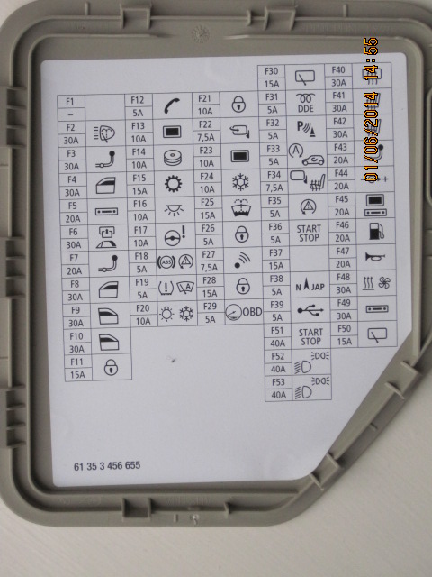

Tyler, since you are a Mini Tech, I have a related question. On the Countryman wiper system, can you get the wiper out of the way by parking it (stopping it) in a up position by pushing the start/stop button with the wiper operating, or remove the fob, or removing a fuse?
Also regarding charging the battery, when parked for over a few weeks, do I have other options to connect a charger other then opening the hood and cowl battery compartment cover to get current into the battery. The accessory sockets don't seem to be live when the fob is removed.
Maybe I'll just install a pigtail to the battery thru a small hole in the plastic compartment keeping the exposed end capped when not in use.
Thanks for your input to this site, B.B.

The wipers will always right themselves in the down position when the vehicle is shut off. As far as pulling the fuse I am not 100% sure. I can try it at work tomorrow and let you know.

Good news. I tried the fuse trick and sure enough they stopped all the way up if you time it right. The fuse is under the hood in the fuse box (30Amp).

Thanks for checking out the ability to stop the wipers in an up position. I've given my self a lesson in where the many fuses are in our Mini. I do own a BMW charger that is used on my K1200LT.
B.B.
Attached Thumbnails How do you replace a CM battery?-001-mini-2012-countryman-fuses-right-side-foot-well..jpg   How do you replace a CM battery?-003-mini-2012-countryman-fuses-left-side-engine-compartment..jpg

So if the wiper blade is stopped at the top, does the arm not need to be removed to removed the cowl?

Correct. That's a pretty good discovery, though it may be difficult to turn on the wipers if the battery is dead
