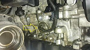

oil solenoid harness
Here is a pic of mine during replacement. My car is an All4 so there is a transfer case with output shaft removed which will not apply to your car.
The right side axle is removed to access the harness, the harness is removed, then the repair kit plugs into it making it longer. The excess wiring created is pushed down into the pan with a tool that is included in the kit.
I think the nice thing about this repair kit is, while inexpensive compared to a new oil solenoid- the better part is I did not have to disturb a nicely factory sealed oil pan....
link to the harness kit, the silver thing is the tool to push harness correctly into the pan. The kit actually comes with an illustrated instruction.
https://www.ecstuning.com/b-genuine-...e/11418609973/

Old Jan 1, 2019 | 07:35 AM
dags's Avatar
dags
Joined: Dec 2017
Did you have to drain the oil in order to install the kit?
Old Jan 2, 2019 | 10:52 AM
All4vin's Avatar
All4vin
Joined: May 2015
Posts: 44
Likes: 10
From: Fernandina Beach FL
No you can leave the oil, the work is at the top as you suspect
