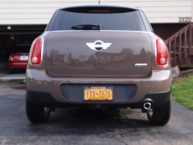

I am in the same boat as you: bike and trailer <=1000 lbs. I'm thinking about the MINI FINI Country-Link since it seems to be the beefiest and most stealthy hitch out there for the Countryman. It's also is Class II hitch and can accomodate pulling 3500 lbs (300 lbs tongue weight). Not that I'd ever pull that amount of weight, but I want a strong hitch!

Out Motoring/MINI Do More are a terrific outfit and have generously supported the MINI community for many, many years. You can't go wrong with their products. Their Class I hitch provides for pulling 2000 lbs and a 200 lb tongue weight. This clearly meets your need.
