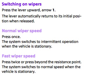

Here is a screen capture from the online owner manual I have for the Countryman. This should clarify
