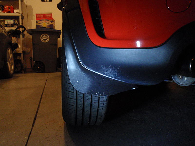

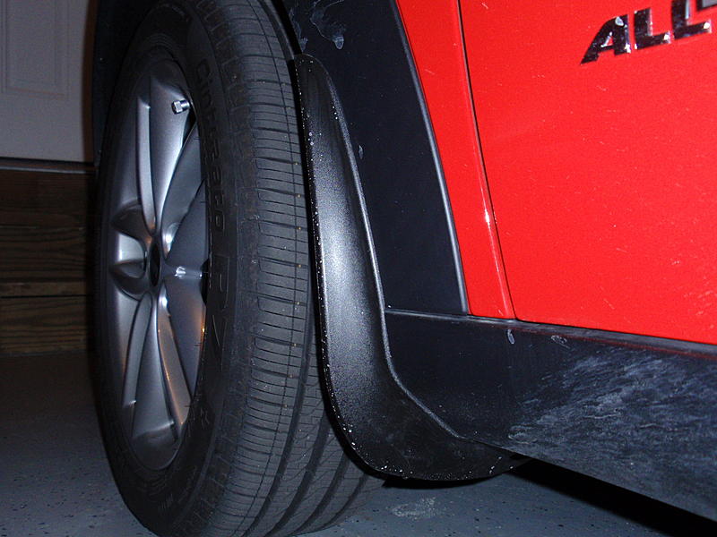

Here are some pics for you

Fantastic. Many thanks.

That sold me! I have to have em too. Are these from the dealer?

Yes, call your parts department and tell them you want the mudflaps for the R60. Also make sure they give you a printout of the installation instructions. BTW, we also get 10% discounts through our MINI club on anything purchased through the parts dept and the boutique.
Part numbers are:
front 82 16 2 166 935
rear 82 16 2 156 545

Was it a fairly straightforward install? They look really good BTW.

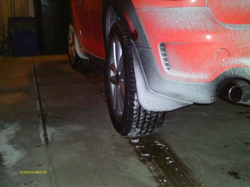

The install is a piece of cake. I did mine back in Dec, in my garage, figure 30-40 minutes top. Tools are minimal, a screwdriver, a tool to remove a couple of plastic rivets and some cleaner, maybe some 3M adhesive promoter. I did not use all of the supplied screws and did not drill any new holes. Hold the flap in place, note which screw/rivet needs removed, install the blind nut and its a done deal. The 3M seal tape needs a clean surface, I have used 3M adhesive promoter with this tape and it really allows the seal to bond to the surface.
The flaps have done a great job of keeping the car cleaner, this winter has been a good test. Plus the looks are improved, they finish the curve of the well.
