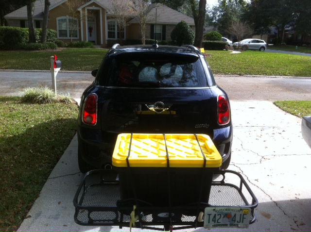

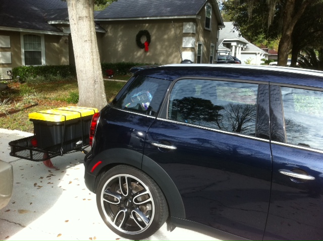

Here's a couple of pics with our cargo carrier attached - had two boxes on the way up.
Attached Thumbnails Pulling a trailer with a Countryman?-hitch-1.jpg   Pulling a trailer with a Countryman?-hitch-2.jpg
