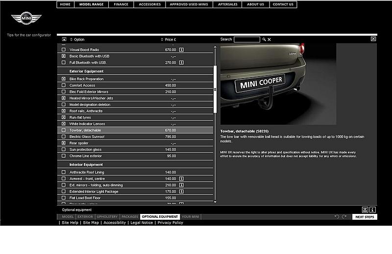

I’m thinking the “no comment” on towing in the USA is a legal position. I talked to a Mini rep at the L.A. auto show and was told Mini does not recommend towing with any Mini and is could void the warranty; but on the UK Mini site they show a tow bar option and claim you can tow up to 1000 Kg (about 2,200 lbs) on certain models
Attached Thumbnails Pulling a trailer with a Countryman?-countryman-tow-hitch.jpg
