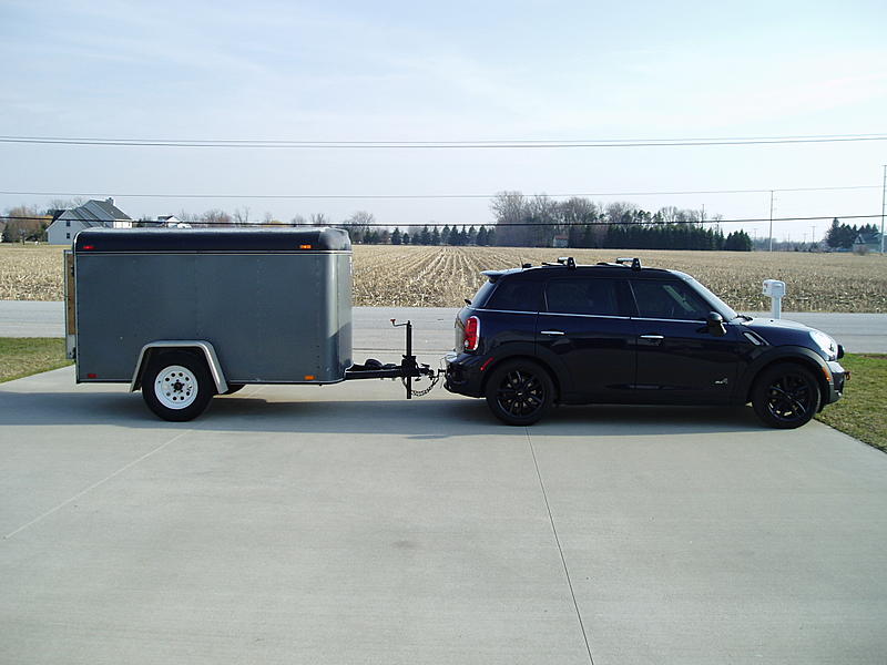

MDM version.
More pics in gallery...
Tow smart!
Attached Thumbnails Pulling a trailer with a Countryman?-p1010078.jpg   Pulling a trailer with a Countryman?-p1010081.jpg   Pulling a trailer with a Countryman?-p1010073.jpg

What's the tongue weight limit on this model? Do you know if it would accept a 1 1/4 to 2" receiver adapter?
Originally Posted by Rev. MINIstry
MDM version.
Tow smart!

Yikes. Only rated for 100 tongue and 1,000 tow -- not even Class I. A solid multi-bike rack with one ride mounted won't be far off that figure, not to mention added stress from bouncing, turning, etc. Hell, between my Thule rack and MTB, they're ~70 pounds combined. Construction appears to be relatively lightweight compared to receivers I've installed in the past. Welds look rough, but hopefully that can be chalked up to prototype? I imagine they didn't incorporate the MINI hex key to reduce additional custom fabrication costs over a standard hex bolt... And it's still a hefty $250, which seems to be the ballpark figure that MINI FINI and MINIDOMORE have targeted for their efforts as well. Has anyone found any other prospects out there?
Caboose Trailers has the dubious distinction of being one of the first (perhaps THE first?) commercially available Countryman hitch receivers on the market and it shows. I like that the receiver is completely external to the vehicle, making for easier access for mounting and inserting hitch pins and locks, but their design looks rather ugly and amateurish -- I'd hesitate to leave it on when I'm not actually using the hitch.
According to MDM's website it's 200 tongue, 2000 tow, which only qualifies as a Class I rating...
http://www.minidomore.com/mini_coope...iler_hitch.php
http://www.etrailer.com/faq-hitchclasses.aspx
