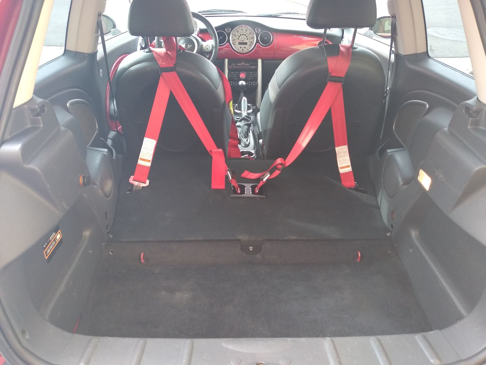

Rear seat delete
OZ Ultaleggera 17x7 with Conti Sport Plus 205/50
Hella front light bar
These mods were done about 9 years and 50k miles ago. Still feels great and at near 20 years old with 116k miles I'm amazed how well it was taken care of. Tight steering and looks great at 5 foot.
