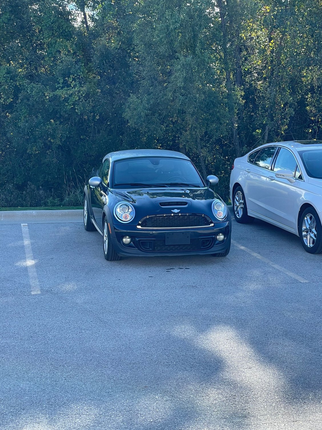

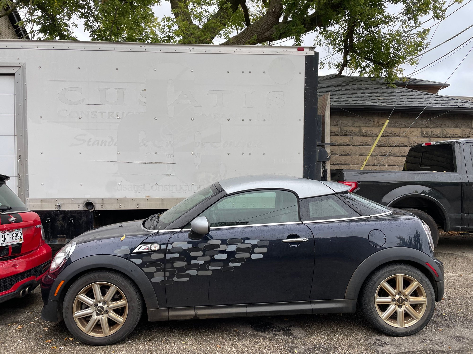

9/20 the day I picked it up from the auction lot in St. Louis, IL. $2880+fees 🤩 Auction stated, “engine damage, non-running.”
Parked outside my friends shop to begin diagnostics. Found ground strap was not connected. Once secured, charged battery and it fired right up. Sitting at 112k miles
Drove it to work the next day as a shake down to see if any other issues would arise. No problems 👍🏽

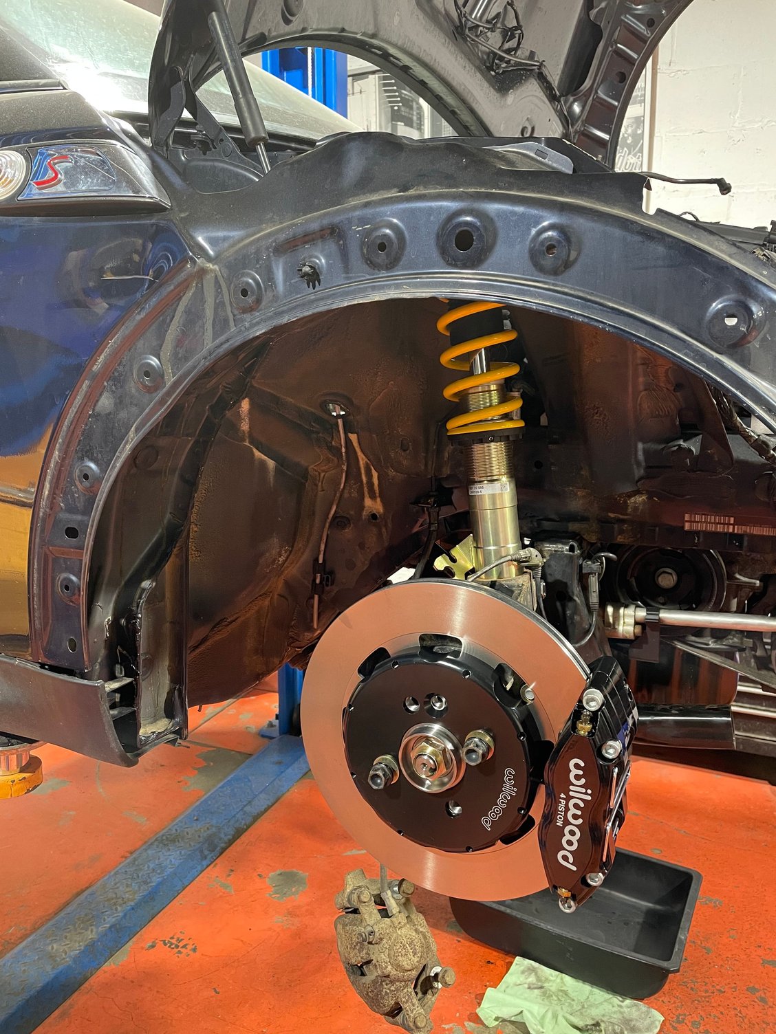

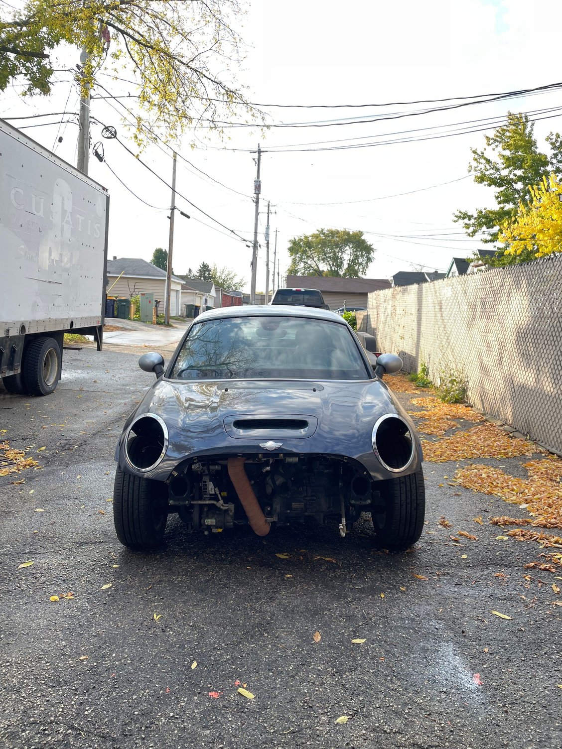

Tear down begins for more powwahhh baby
Beauty shot
All typical maintenance performed. Timing chain, water pump, walnut blast, thermostat, gaskets, etc.
Rear beauty shot

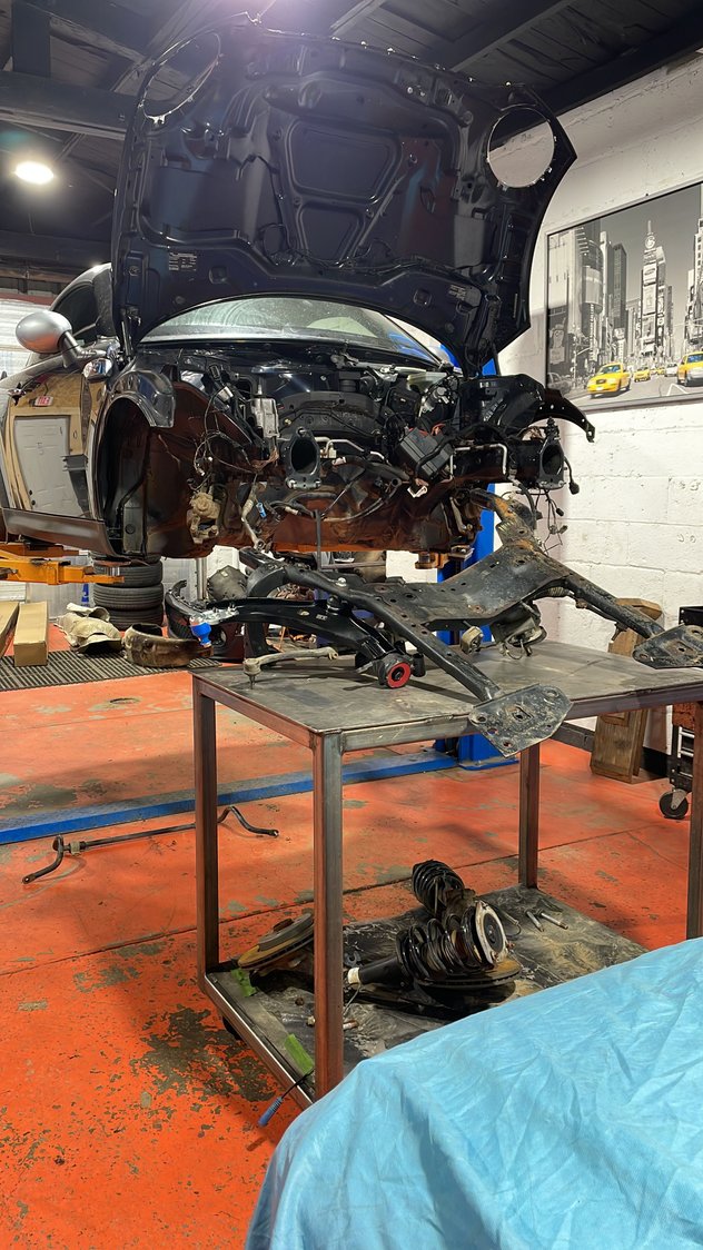

Rolled outside with the custom heat wrapped DP poking out while we tear down the R56

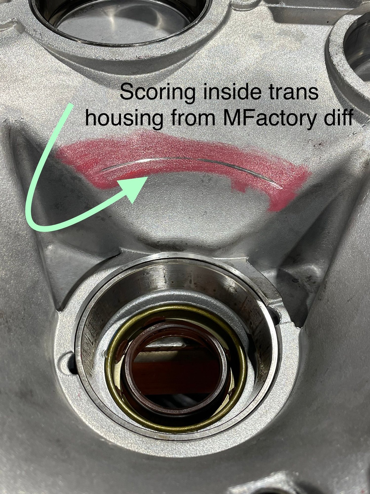

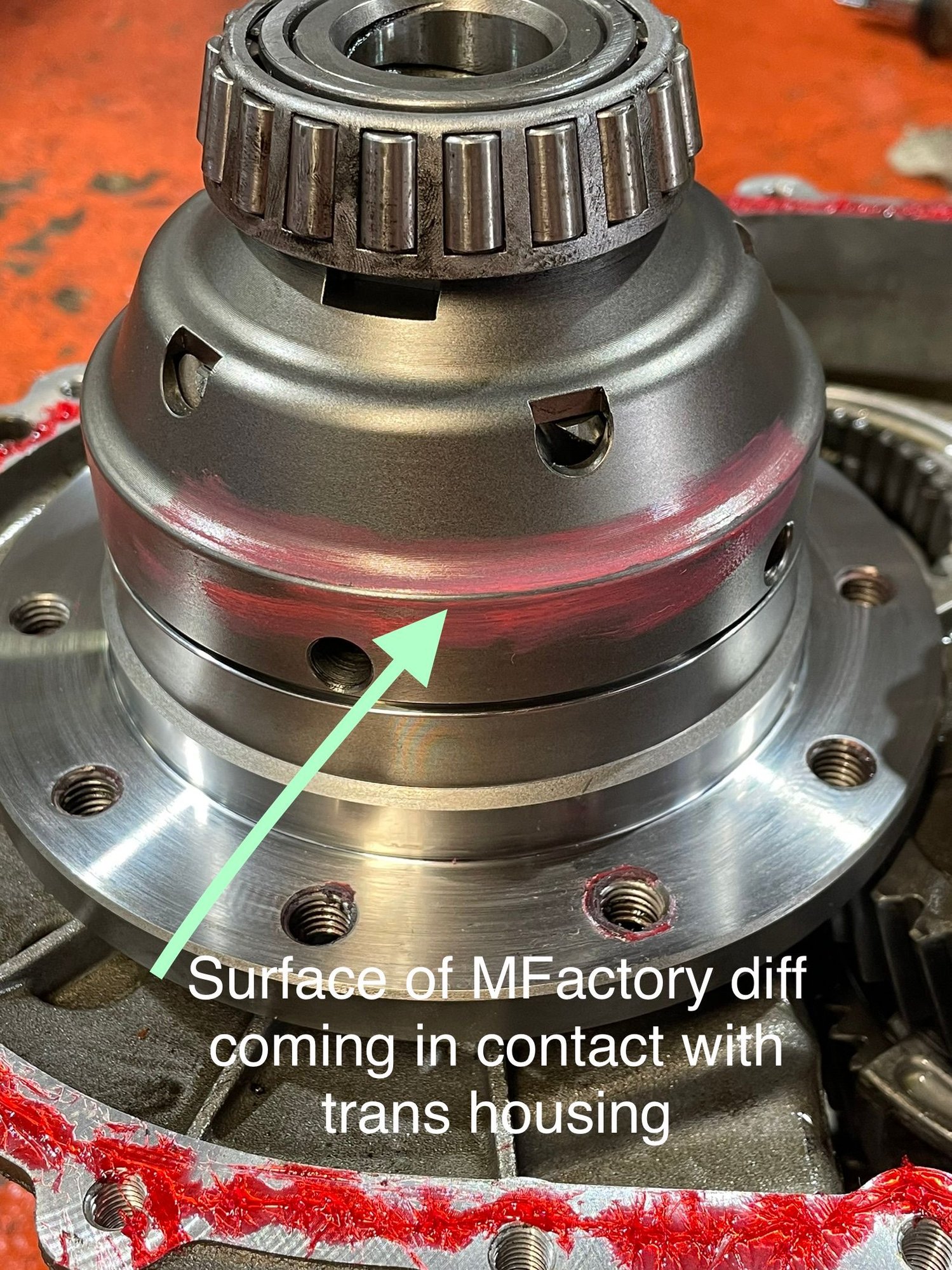

MFactory helical differential install was a bit of a pita.
Trans case would not go back together with the diff installed
The upper diameter was slightly too large to the point it was making contact with the trans case.
Visible scoring from the diff inside the trans.

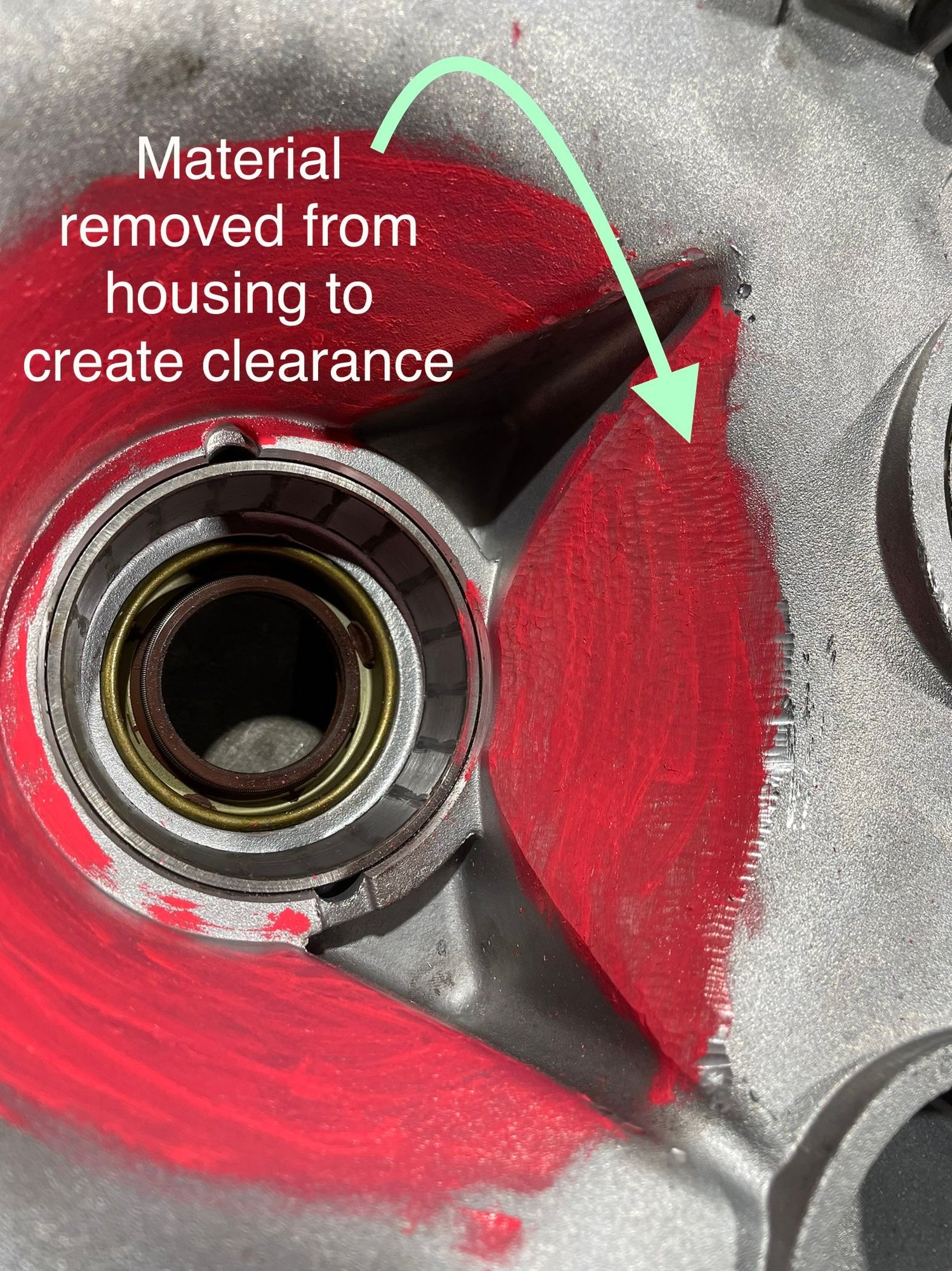

As much as I hated having to do this, the only way we were going to get the diff to fit was to carve out the inside of the trans housing. I’d say around 2-3mm was removed from the area that is died pink. Trans closed up and back in the car.
