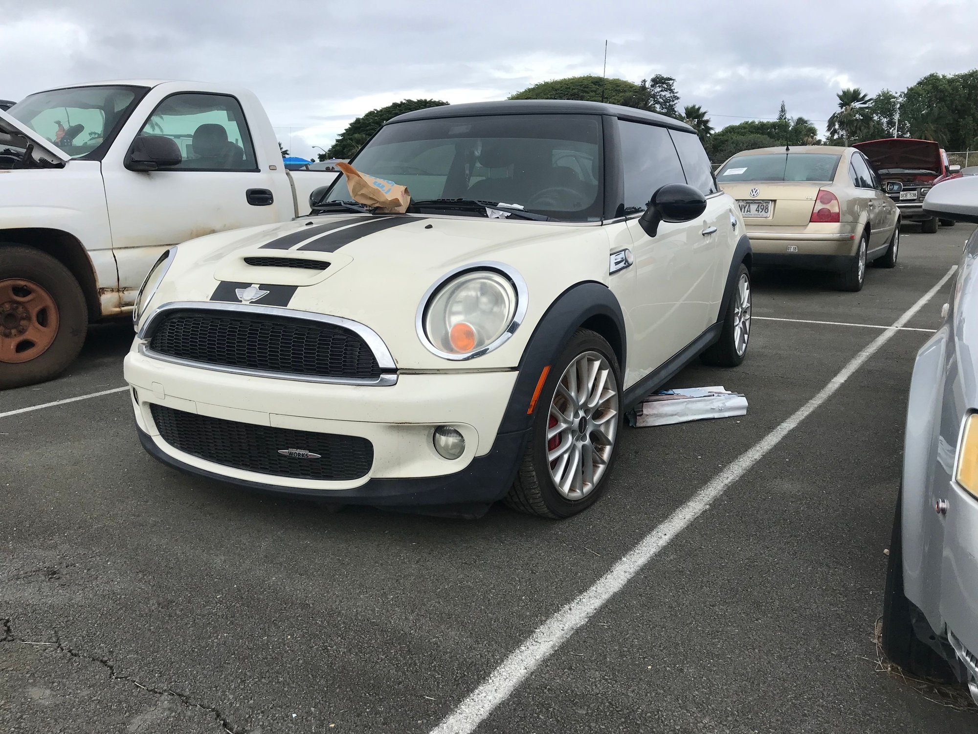

Mini #1

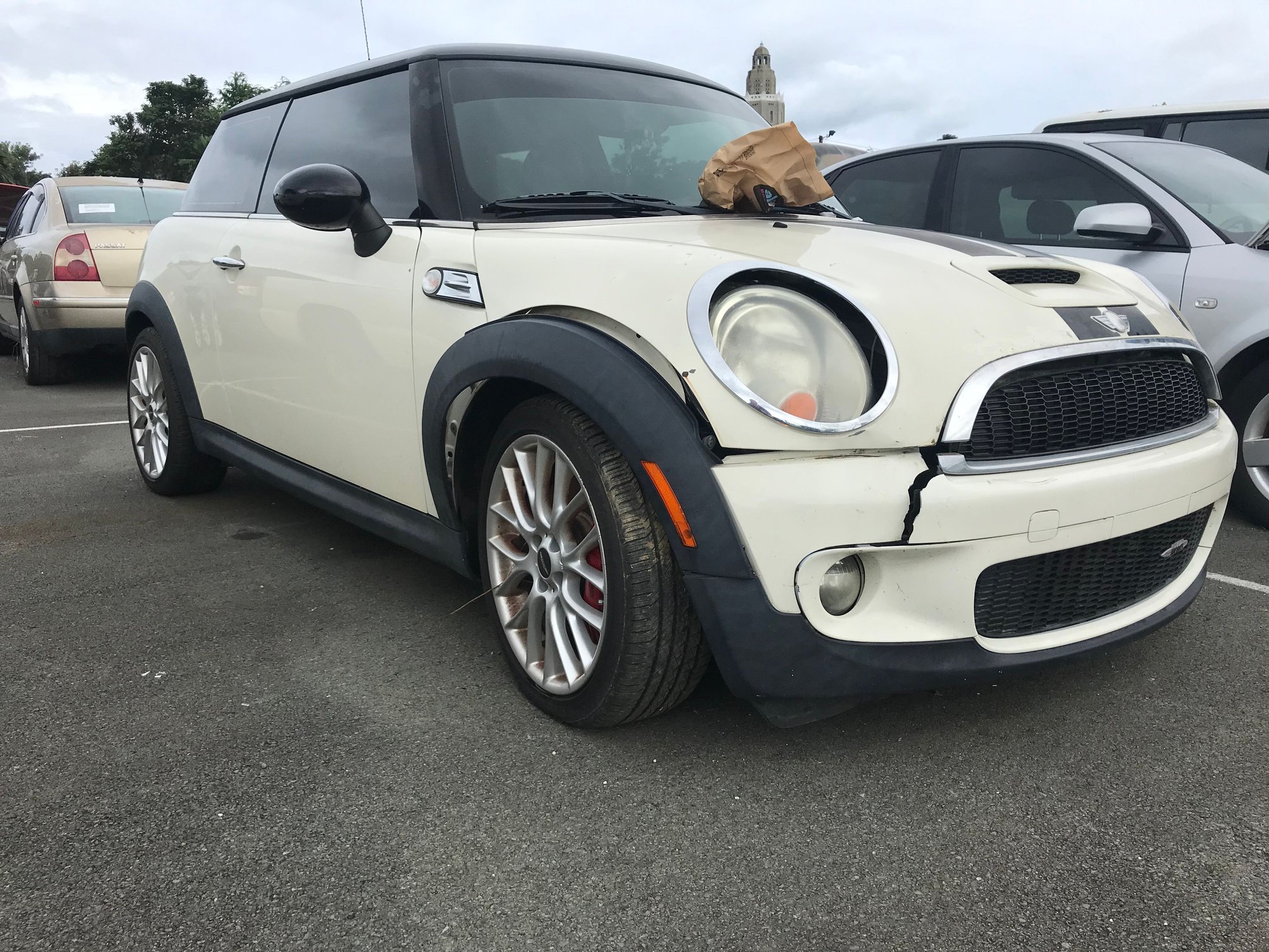

Mini #2

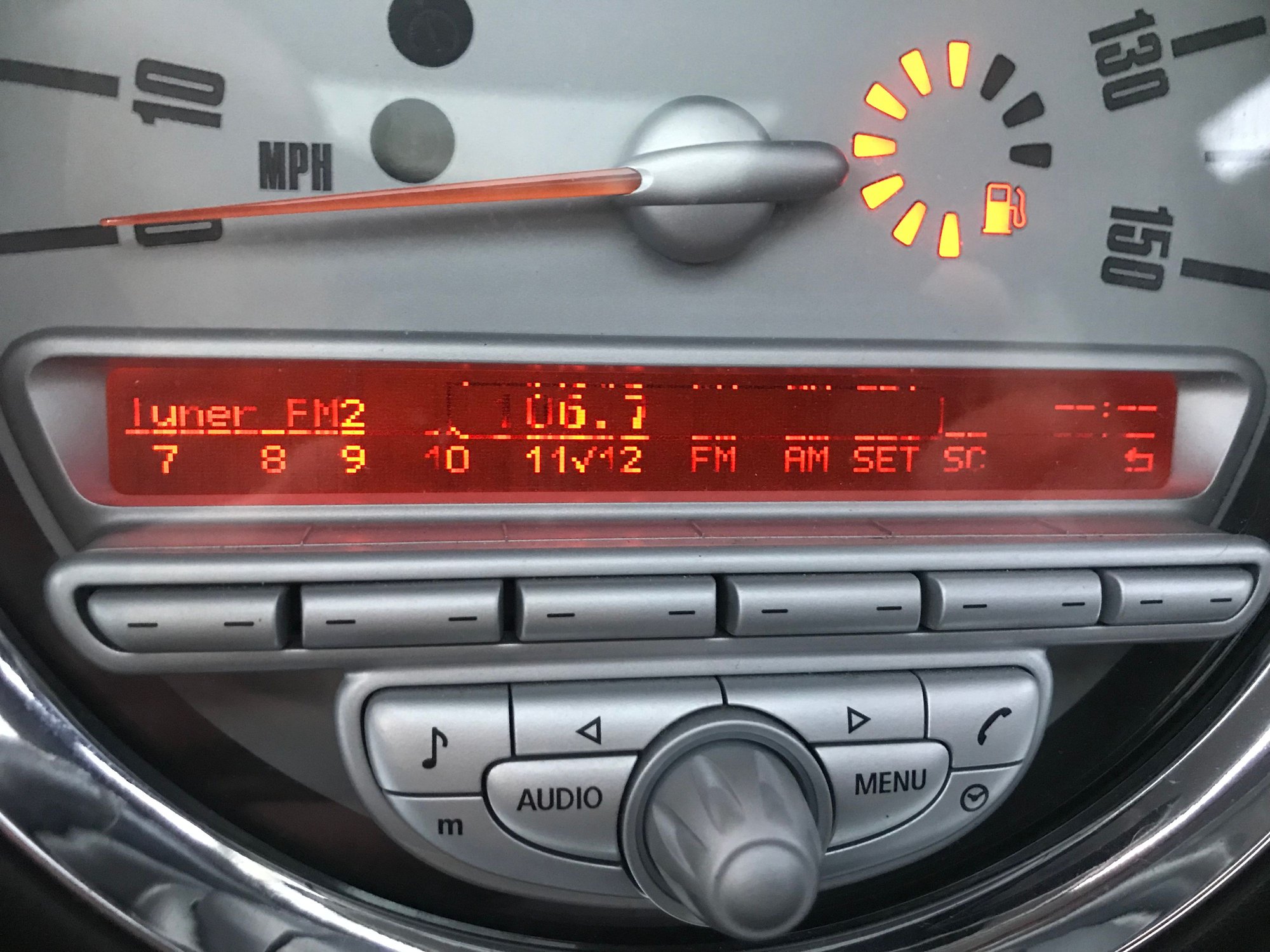

Mini #1 display early in a drive
Mini #1 display later in the drive

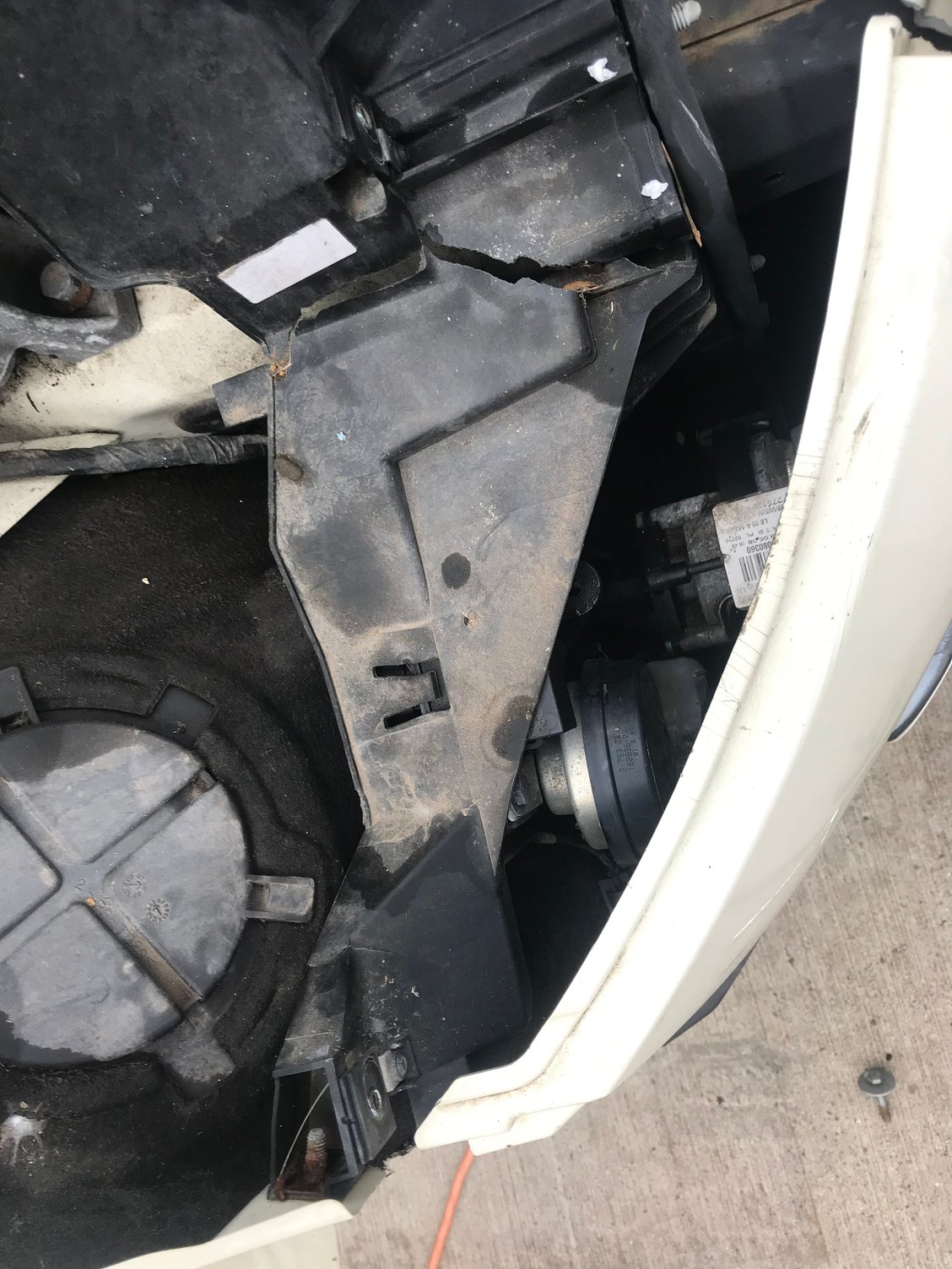

Mini 2 damage as purchased.
Old vs used replacement headlight.
Here is the broken plastic radiator support.

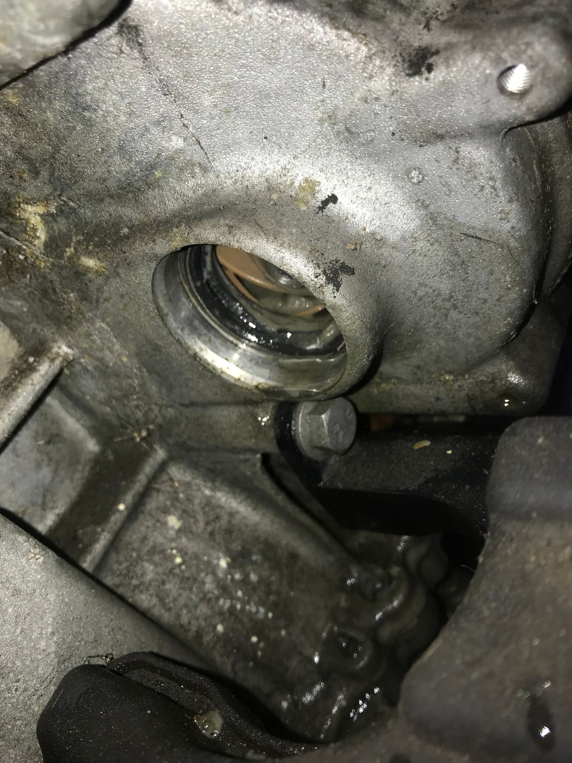

Mini #2. I had some time on the holiday and the power was out at my house for like 6 hours. It was during a rain storm so I set up a 10x10 sunshade tent over the car to deflect the rain. I’m sure everyone who drove by had to do a double take. I still got completely soaked, but hey its Hawaii and it was a warm rain. Anyway, I confirmed the leak but also found additional damage to the cooling system. I ended up pulling the intake manifold to get to the water pipe. Now I’m on hold for parts to arrive. I will prob take a look at the intake valves and walnut blast them while I’m waiting...pictures below.

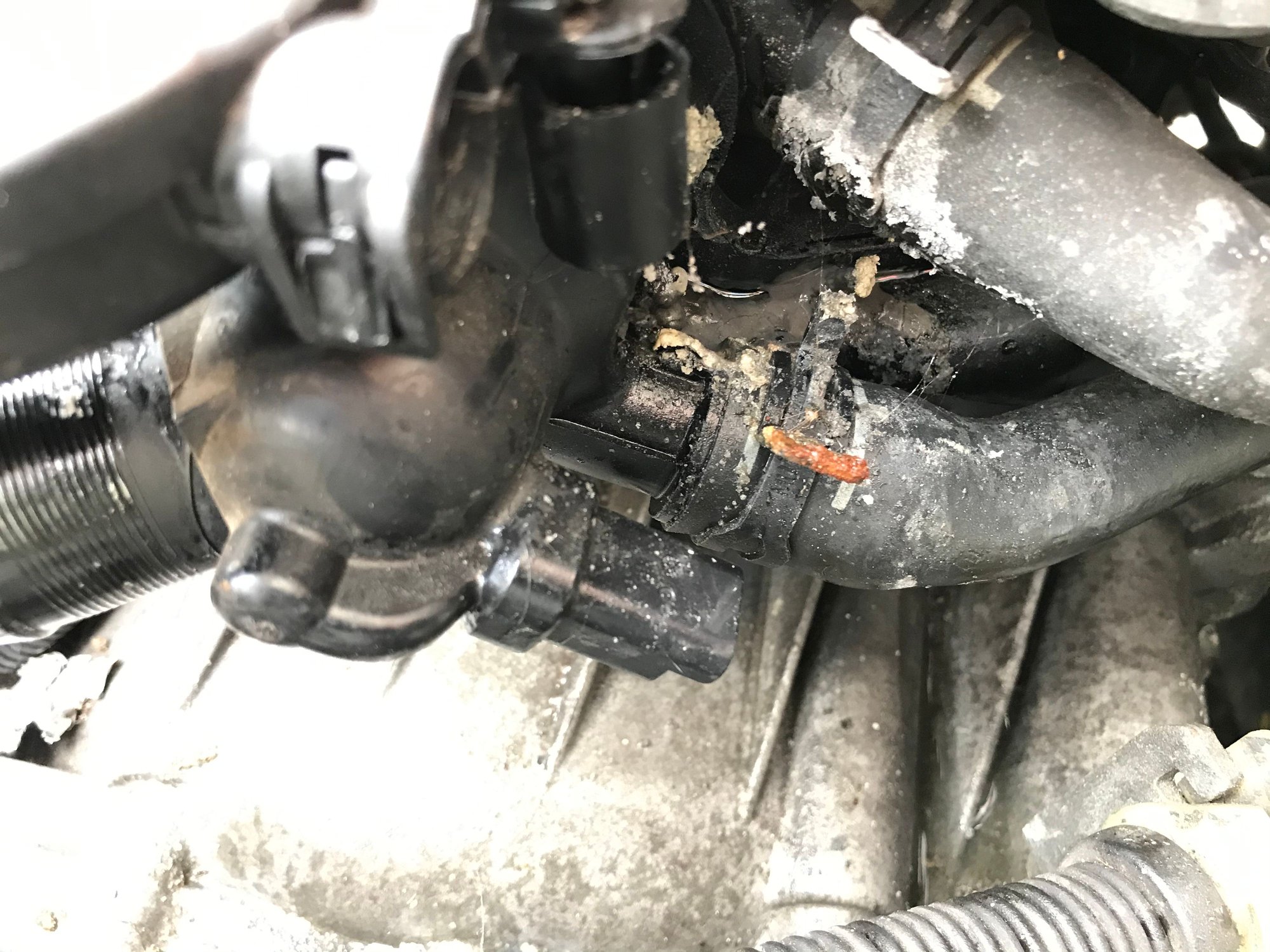

I think that I also found the source of the terrible smell in the interior. The passenger window is in the state where it is down just a fraction of an inch (like when you first open the door to assist the glass clearing the roof gutter). During the rain storm, I got into the car before I started working on it and there was already a pool of water in the passenger floor boards. As a reminder this car came from an auction and who knows how long it sat out in the weather. Now I will definitely remove the carpet.
Suspect leak on thermostat housing. Not liking the look of the grey slime!
Here you can see the crack.
This is what bothers me the most. It appears that radiator stop leak was used in this motor. I’m going to do some tests with this housing to see what if any chemical treatments will remove the sticky residue.

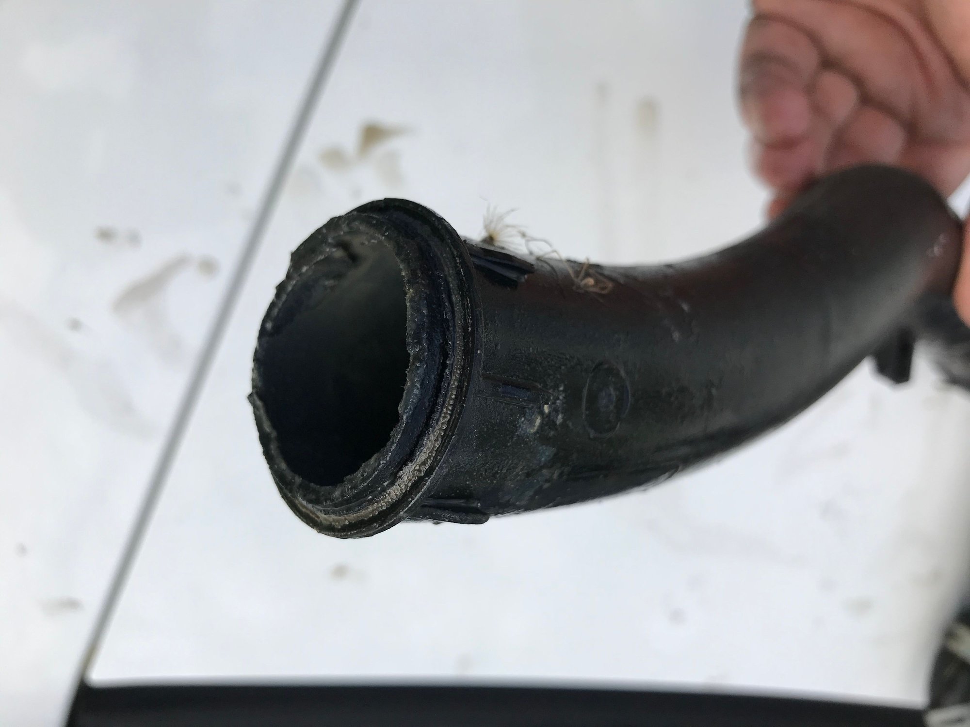

The water pipe snapped off inside the water pump.
Here is the other end of the water pipe.

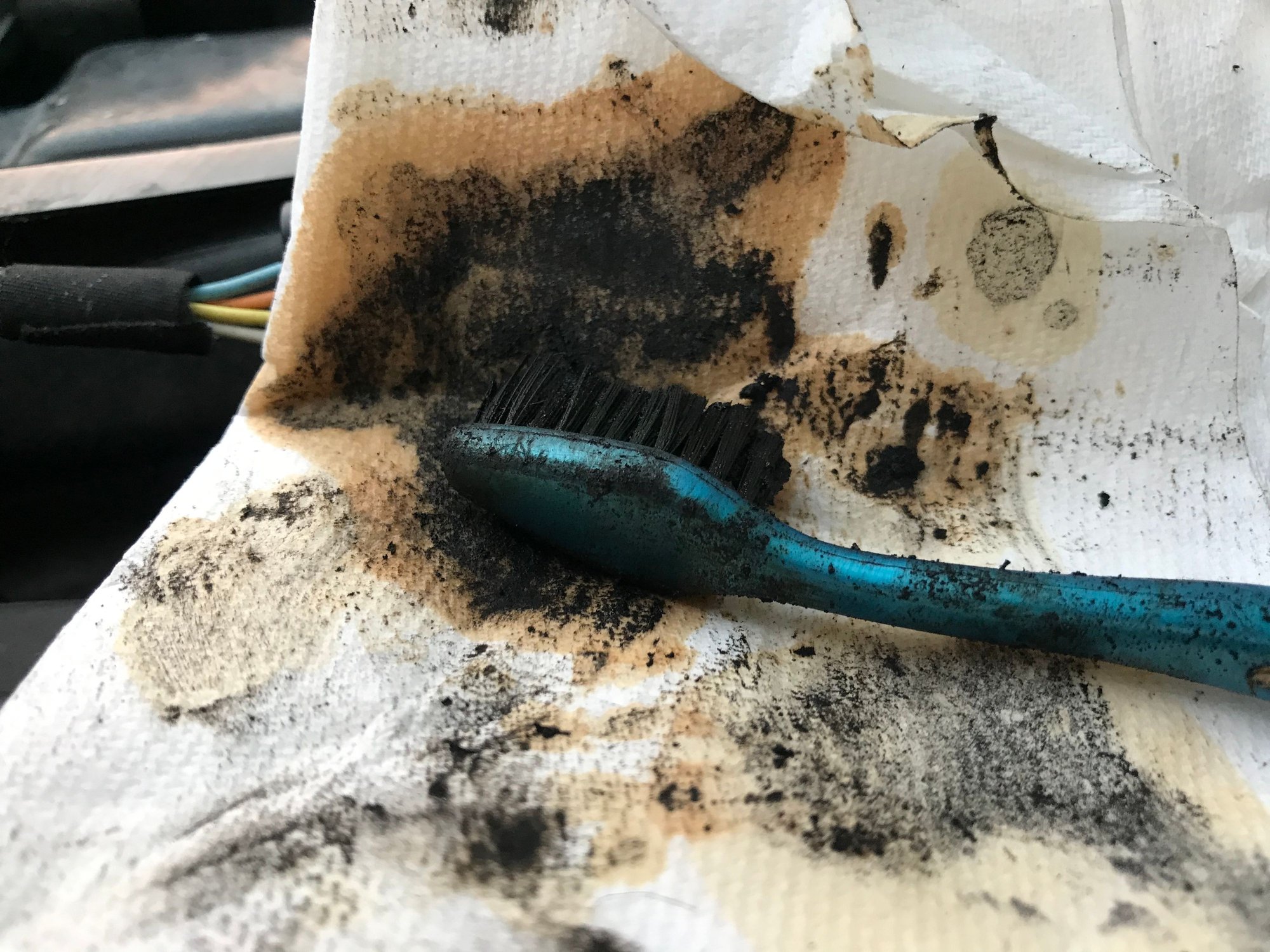

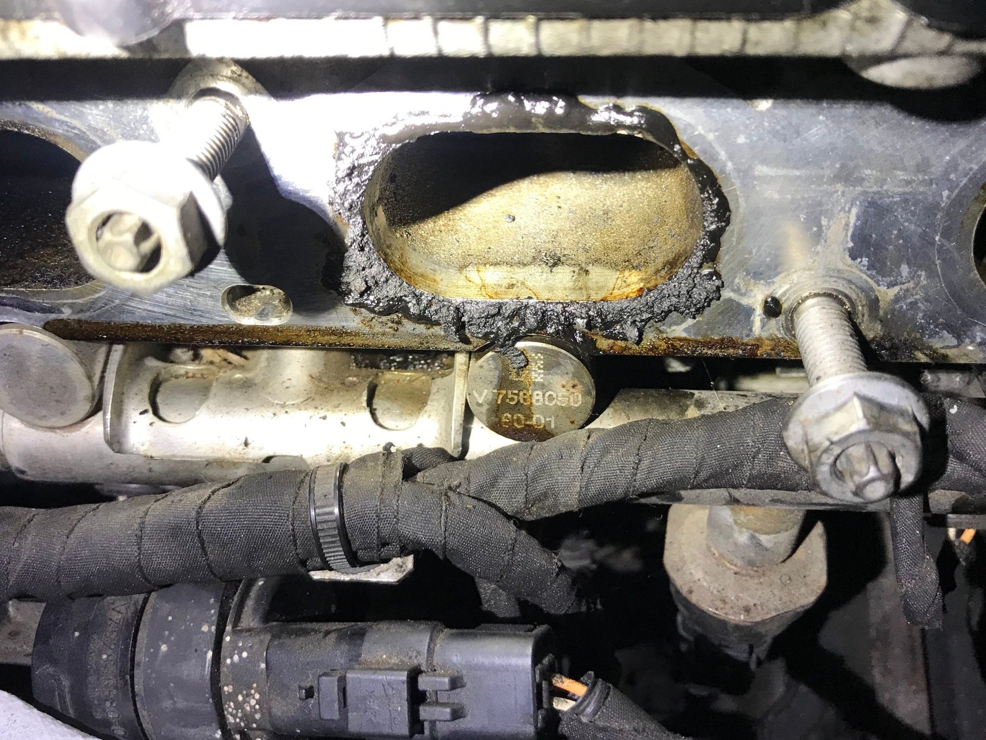

While everything is is pulled apart I decided to clean the intake valves. I only worked on one port and I am going to need more tooth brushes, LOL.
Thick carbon mess.
Here I was just pulling it out of the port.

Yep, bet that was used there. I would try the best flush fluid you trust and then back flush the system. You will need a hose, I would clean the rubber hoses as much as you can.

Yep, bet that was used there. I would try the best flush fluid you trust and them back flush the system. You will need a hose, I would clean the rubber hoses as much as you can.
I have been reading lots of threads on best chemicals used for flushing. It looks like it will be a multi stage application. I'll post my steps and materials used if it works good.
