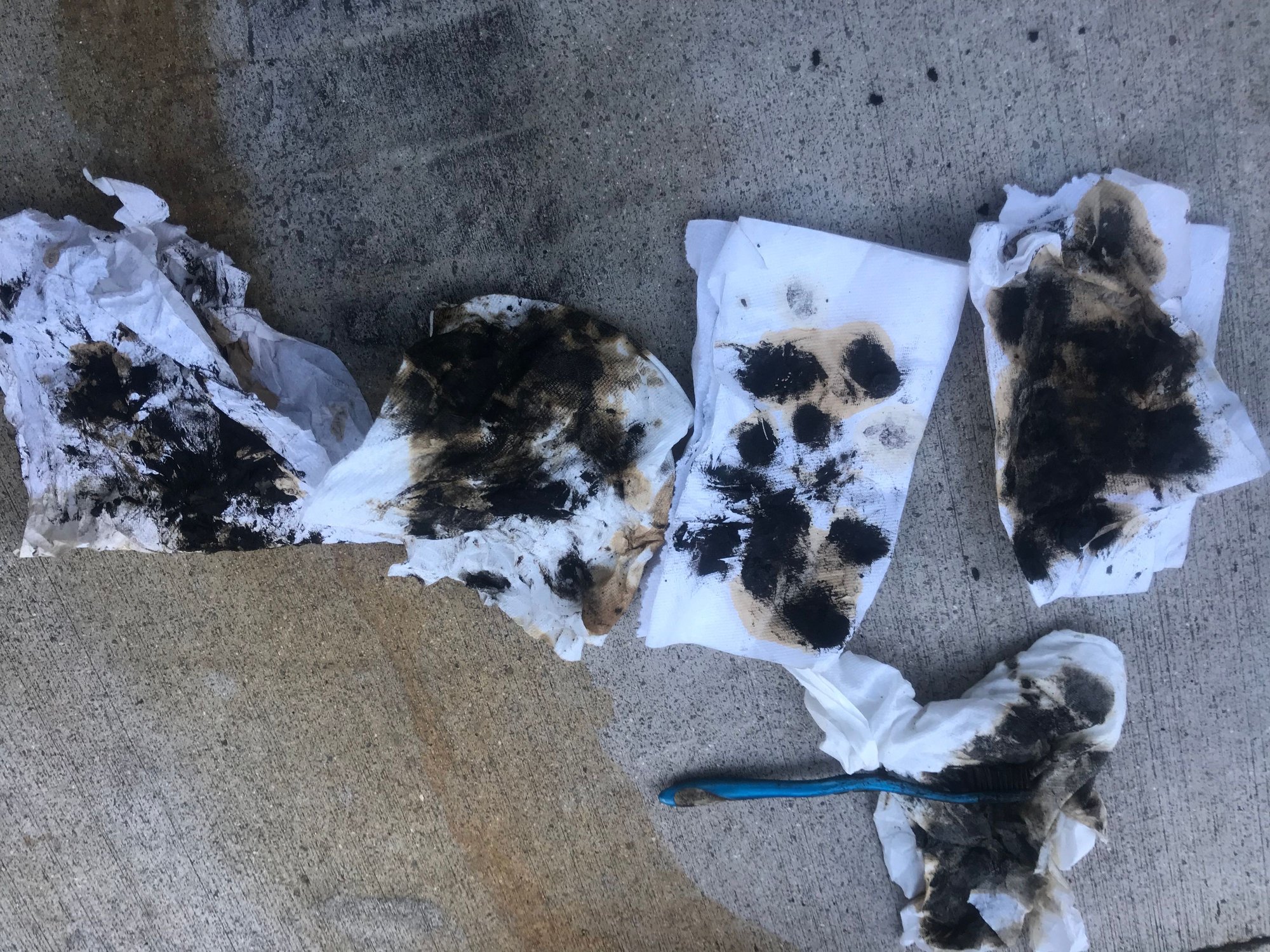

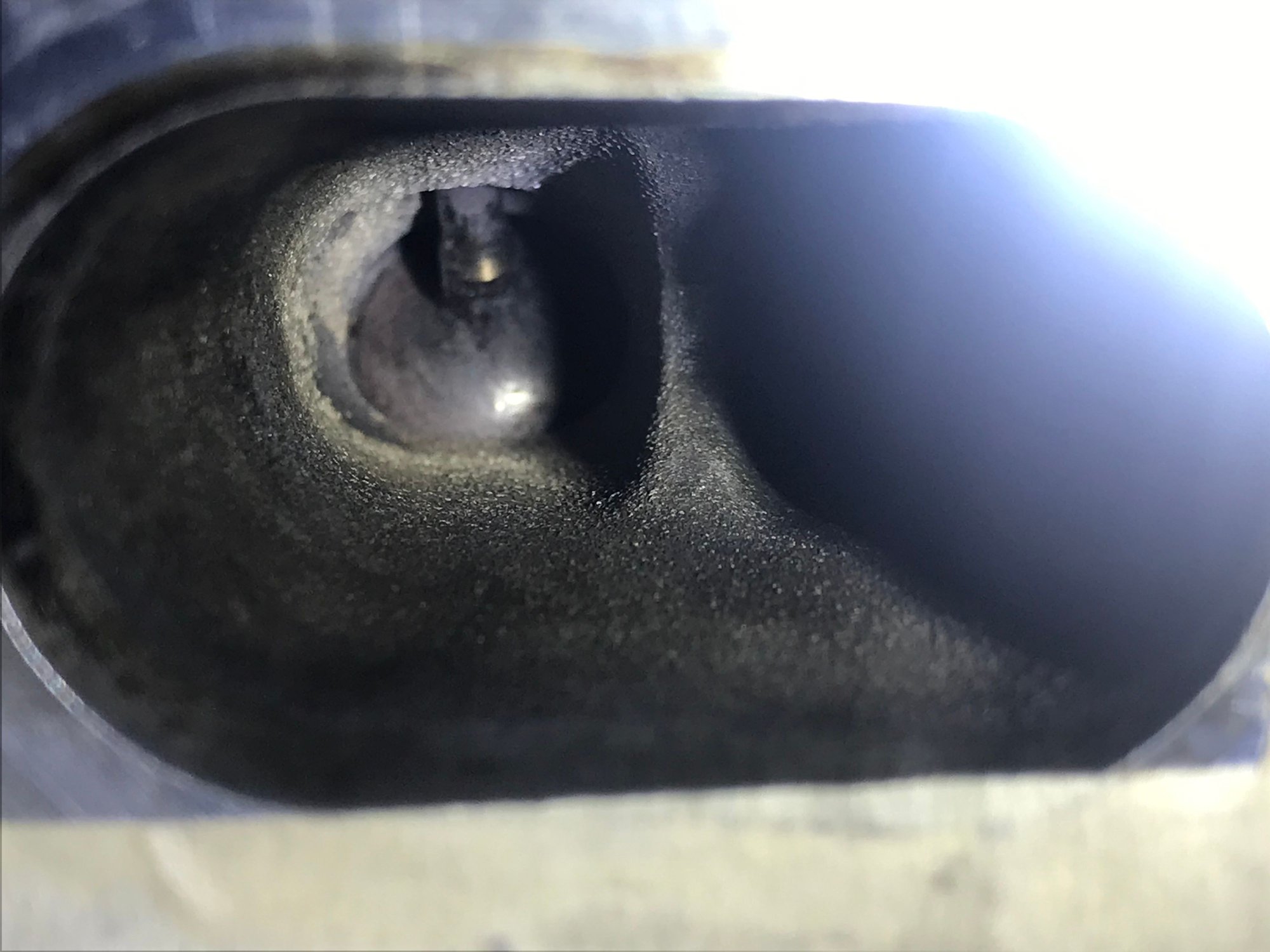

Mini #2...I worked on cleaning the intake valves today. Soaked 2 at a time then brushed, blew out, then scraped off the build up. It was a slow and painful process. I squeezed my head down between the firewall and the cylinder head to get a straight sight line and worked away. I did try walnut blasting but my gun was too wide to maneuver and the tip was too short to really get down in there.
Once my neck was killing me I gave up and pulled the water pump off and cleaned the housing area.
Then I decided to pull the bumper cover off in preparation for the plastic welder that is in the mail.
Almost done.
This picture doesn’t do justice to show how much crud came out.

Next I went over the intake valves one more time. They are now as clean as I can get them. To recap I used a combo of soaking with brake cleaner then scrubbing with a toothbrush then a set of dental picks mixed in with some walnut shell media blasting with a shop vac and finally another rinse with brake cleaner and a blow dry with shop air.

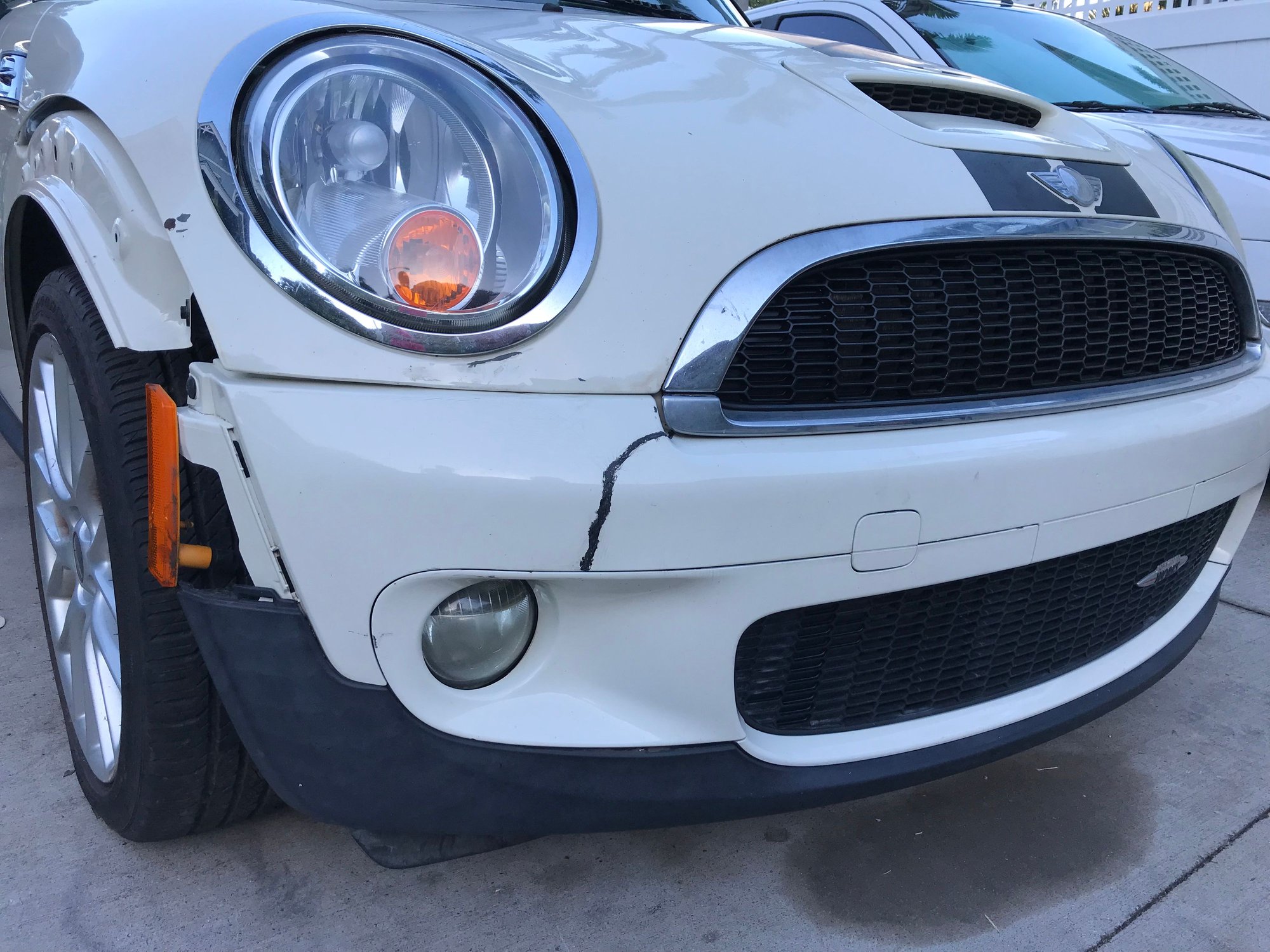

It was still early and nice out so I wanted to do more. The plastic stapler and plastic welder had arrived the day prior so I popped the bumper cover off again and gave it a wirl. Man I wish I owned these tools years ago. They worked awesome.
First I used a Dremel to clean up the sides of the crack and remove a little paint (about 1/8 of an inch) around the split. Looking back now I would not have touched the paint on the front. The stapler worked so well and kept the split so tight that it would have only looked like a paint crack after the repair. But you’ll see in the picture that I have a 3/16 black scar line.
Next I installed the hot staples on the back side. I put them about 1/2 inch apart along the entire split while holding both sides tight against each other. The kit included a pair of side cutters to cut off the legs of the stapes once they cooled off.
Then I used the plastic welder and added new material on top of the staples. It’s not pretty because the nubs of the staples were sticking up and would catch the tip of the welder. But it worked well. The bumper cover material melted quicker than the plastic welding rods that came with the kit. This made sure both of the plastics infused together for a stronger bond.
I ran the welder along the front (paint side) of the bumper. It will definitely melt your paint. I added a very small bead of new plastic on top of the crack and them smoothed it out. Again, hind sight but next time I will leave the front alone unless I am ready to completely repaint the bumper. It would look much better right now if I didn’t mess with the front.
I used the plastic stapler on the broken broken radiator support as well. I trimmed the legs with a dremel and got them flush with the support. It work much better than clipping them with side cutters.
I reinstalled the bumper and snapped a photo. What do you think?
Bumper repair minus finish sanding and paint.

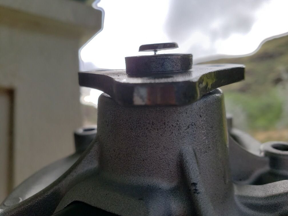

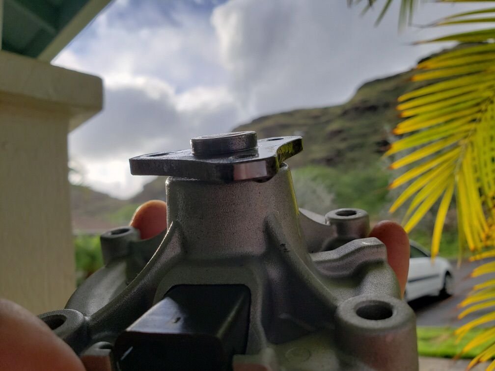

The water pump came in and I installed it. I cut down the nose of the shaft to mount it easier. It was still a pain in the butt. I removed it when I had the intake manifold off and accessed a couple of bolts from the space where the manifold sat. Unfortunately, I had already installed the manifold and just couldn’t get to a couple bolts. I supported the engine and removed the passenger motor mount to finish the job.

Here are are pictures of the water pump. I used a cut off disc from a Dremel. I worked slowly and cooled off the water pump shaft in a bucket of water after every couple seconds of cutting. It never got warm (I was able to touch it the entire time). I am confident that no damage as done to the seal or bearing in the pump.
This is made installation much easier. I actually slightly damaged the old pumps plastic impeller when I removed it because of the overall width and the small space between the motor and the frame rail. The new one went in much smoother.
Just a sliver of material holding the nub that I removed.
Comparison either old pump on the right.
Trimmed flush with the pulley flange.
