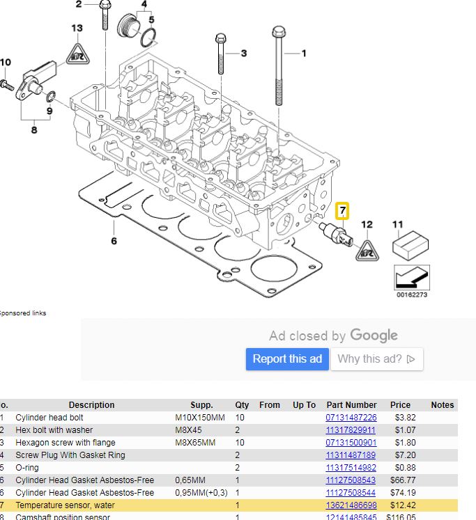

and the thermostat in the tach is pegged at at -40 Fahrenheit lol.
This could be a bad sensor or the sensor is not connected, you will have to trace the connector wire for this one, Look at image"TempSensor.jpg" for location.
That is the outside temp. More than likely the sensor behind the front bumper, or wiring issue to that sensor
