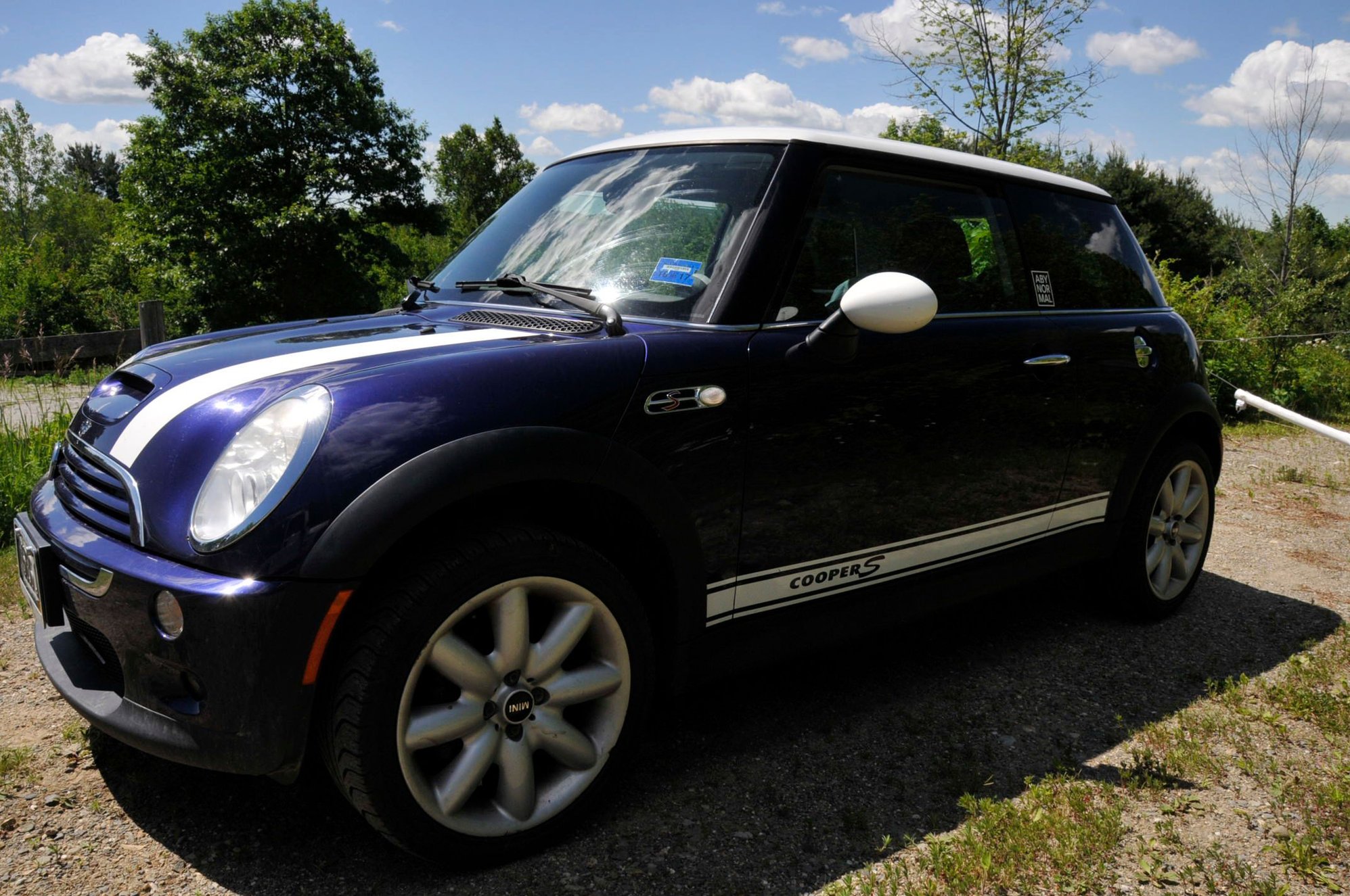

The lifted 06 has me feeling just how you described...could be great...but im cautiously optimistic. You're right about the lift...current owner lives down a long gravel road and driveway. Here's a list of the mods to that car and a pic:
JCW Intake
Cravenspeed Strut tower defenders
Stainless steel Remus exhaust
Coopercrap brand 2″ lift
Rennline Aluminum skid plate
