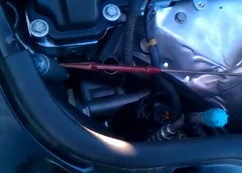

I checked the motor oil, and it's 2/3rds up in between that round orange marker which looks something like this...
<>-----------<>=====================O
| Oil here
Any thoughts and/or advise? I'm quite concerned.

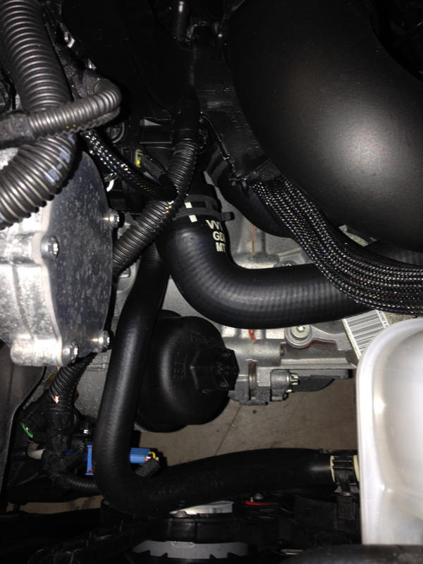

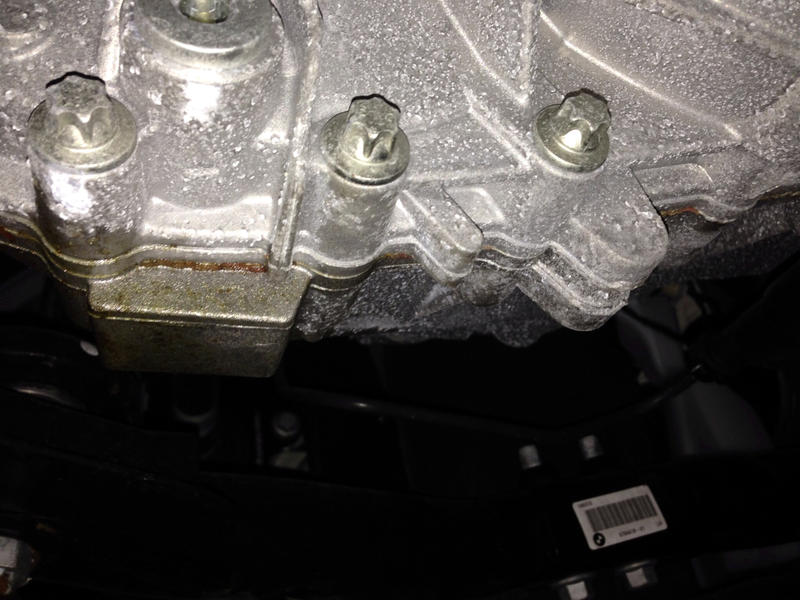

The oil was leaking from this squarish looking piece. It had a small oil bubble building up right below it.
Not sure what this is in relation to the engine though. :(

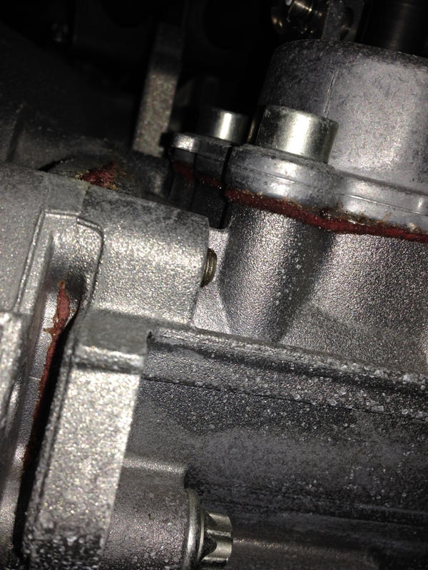

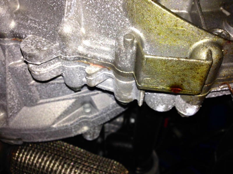

Here's a few more images I just randomly shot with my iPhone under the car. Sorry if they're not sequential .. I was trying in pure darkness to capture different areas of that section.
Does anyone know what this may be, or how serious it is. Again, this is our very first Mini, so please pardon the ignorance. :(

You don't say how many miles are on your vehicle, but in any event that leak looks more than is to be expected with a MINI that is only 1 week old. Take it to the dealer.

This looks exactly what I had on my then brand new 2013 JCW Hardtop. We thought it might be the LH axle seal, but it wasn't. Turns out it was some left over preservative that didn't get steamed off after ocean shipment. Heat from the engine had melted the residue. At about 2000 miles it had totally dried up. I now have 6,600 on him with no further evidence of anything leaking or dripping. BTW My JCw is a manual. You didn't indicate which your's is.

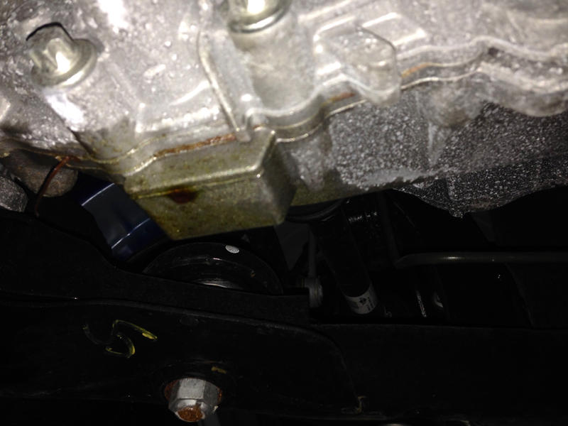

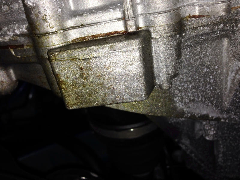

Jab: I just made 380 miles on it. Here are a few shots from above. Tried to see if maybe leakage was coming from topside. I believe that's the oil filter I'm looking at. In my YouTube research it appears in order to get to that filter one had to first remove the water coolant reservoir, so I'm not sure if that's the oil filter housing or not.
My Mini is a 2013 Mini Cooper hardtop 6 speed. Sent from my iPad Air using NAMotoring Guru: it's a 6 speed stick.

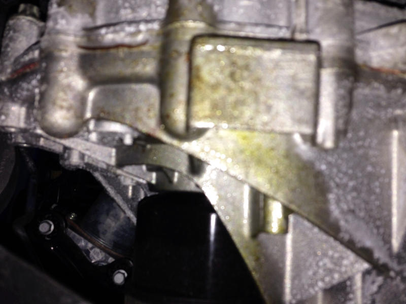

Darnit!!! Well, I wiped the oil yesterday, and to my disappointment a tiny accumulation is showing again this morning. It's hard for me to get a good picture as the car sits low, and my arm doesn't reach from the front. However, today I'm going to drive it on the car ramps so I can get a better view. I'll snap better images then. I suggested to my wife maybe I should spray engine cleaner in the event it is "left over" fluid, but she feels I may void the warrantee or remove the ability for the service dept. to see where this leak is coming from.
I'm quite concerned. But as the saying goes, "No sense worrying about something you can't change." I'm only sad because I just love this little car, and having oil leak after one week, with just over under 300 miles is quite saddening. :(

Originally Posted by Eddie07S
Good you can read the dipstick. There are posts about the problems people have with them. As for the oil level. The owers manual says these engines take 4-1/2 qts (with filter change). When I change my oil, I will start it, turn it off and let it sit for a while. The dip stick reads at the full line. If I go out to the garage and check it (cold), it reads full. So, it seems it doesn't make a difference. I wouldn't start it, turn it off and then check it as there is oil sitting elsewhere in the engine that won't show up on the dip stick. The important thing is that the car is on a level spot when you do check it.
Hi Eddie, Thanks for the feedback. Tomorrow I'm going to call the dealership and see if I can schedule an appt. for the leak. My wife says maybe I should wait a while (like the dealer said) and see if that goes away. I didn't drive it on the car ramps to see as I'm afraid of what I might see. I know this is going to sound stupid. However, I feel this strange attachment to this little car. Maybe it's because it reminds me of my college days when I drove a Honda cvcc (the first car I learned how to drive a stick with) and one couldn't kill that thing. I remember it was tiny, and the front dash was kinda curved. Well, this MINI for some reason has this place in my heart. It's small, roundish, reliable, manual speed and I just feel attached to it. Odd coming from a 53 year old man huh? All this said, I baby my MINI, not because he's new, but because I really like him. I've hand waxed him twice to protect against the Florida sun, last Thursday I tinted his windows, using high end tint, to reduce inside temperature by 30 degrees, I detailed the inside with protectant, and yesterday received my MINI sun deflector for the front windshield (seen here). So here he is, ready for the workweek (topped-of with Shell V-Power 93 octane which is a Top Tier listed merchant), in my driveway. Last night I kept thinking about that darn oil leak. Hope everything will be ok (fingers crossed). Regards, David Sent from my iPad Air using NAMotoring
Attached Thumbnails Oh nooooo!!!  New Mini, tiny spot of oil. :(-image-3352344295.jpg

Some of that oil looks red to me. Could it be transmission fluid?

@Son-of-MINI: The oil looks reddish in the picture but it's actually synthetic oil colored. Sorta clear/yellow and oily texture. I have been watching that little dropper since this morning and it hasn't dropped yet. In fact, I drive it to top it off with fuel for the workweek and it hasn't changed. Nothing has dripped on the floor, and that tiny droplet you see in that pic has remained static since this morning. :(
