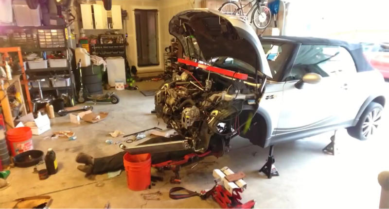

Guys, I'm trying to find online just how involved replacing the front transmission seal is. Guess I'm trying to determine two things:
1- That they actually did this work, and not pour some stop leak in there (seems quick to be completed)
2- If the seal was replaced, just how involved is this?
I looked on YouTube and ran into this clutch repair thingy. Dear LORD, if what was done to my MINI is THIS involved, will my MINI ever be the same? My gosh, this is frightening. :(
Anyone know if replacing a front transmission seal for a 6 speed involves something as horrifying as this ....
Regards,
David

Well, my MINI and I were reunited this morning and everything appears to be OK. The repair invoice (no charge of course) reads, "673 driver side output shaft seal failure - removed driver side axle shaft seal replaced with new. Topped off transmission fluid. Test drove. Leak did not return, issue corrected."
Hope that does it. I asked the Service Adviser if this was a complicated task, and he stated it was quite simple to do.
As promised, I said I'd let everyone know the outcome. Thanks to everyone for your time, advise and much valued feedback.

They have to remove the transmission, maybe separate the casing. I wouldn't worry, they should be able to put it back together just the same. Good thing is you have plenty of warranty if there is a complication.
Edit- just the axle shaft seal, that's not bad at all!

Not sure what the last poster was trying to say with his edit, but I don't believe it was necessary to remove and disassemble the transmission.

Thanks Rick and JAB. I wasn't sure what was being replaced when I left. I remember hearing inner seal, so I started searching on Google. My wife heard me say, "Oh nooooo!!" She came in and asked what was wrong. I told her, "They're going to MUTILATE my MINI!" as some of the images I was seeing involved practically tearing the whole front half of the car down. Needless to say I was worried, because despite being a MINI dealership/service establishment, one can't help but worry if it would be put back as it was.
I guess the driver side axle shaft seal isn't so bad. I'm at the office, but will take a peak when I get home underneath.
Wheeeeeew. :(
