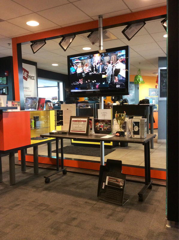

Currently at the MINI service center. They're very accommodating (BEST coffee). Strangely, I was told I'm due for an oil change at no cost to me of course. Huh? I only have just under 400 miles on him ... what happened to every 10k?
I'll keep my fingers crossed, and hope all is fine. They said if they need to keep the car more than 3 hrs, they'll put me in a loaner.

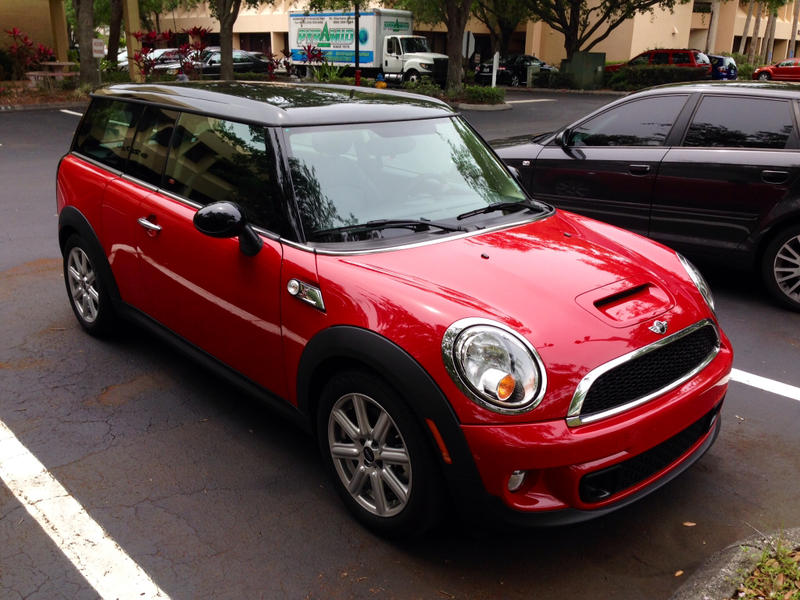

Here's my loaner while my MINI-Me gets fixed. Should have him back by tomorrow evening, so I was told. In the meantime, I get to drive an "S" loaner.
