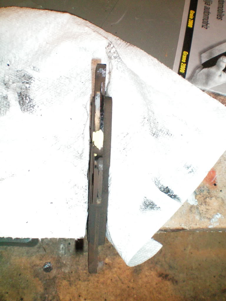

Here's a picture of a nearly new GEN2 MINI front pad. I put a little white paint on the backing plate to make it show up
Here's a worn pad with similar white
btw on the good MINI pad you'll note the edge bevel .... now look at the worn pad ... for these MINI pads, if you can see bevel you'd appear to be OK ... no bevel = time for new.
Note that the wear sensors are only on the left front and right rear wheels, and then only on the inner pads. I find them pretty useless and have jumpered them....
Sensors that have not 'tripped' can be reused (if you can get them out of the old pad w/out destroying them). Like I said I bypassed mine. You can not simply remove them tho because a missing sensor is seen by the computer as a worn sensor and you won't be able to get rid of the warning lite.
you don't mention what MINI you have but all the above applies to both GEN and all models. (btw there's a ton of good info in the Brakes and Tires forums . . .)
