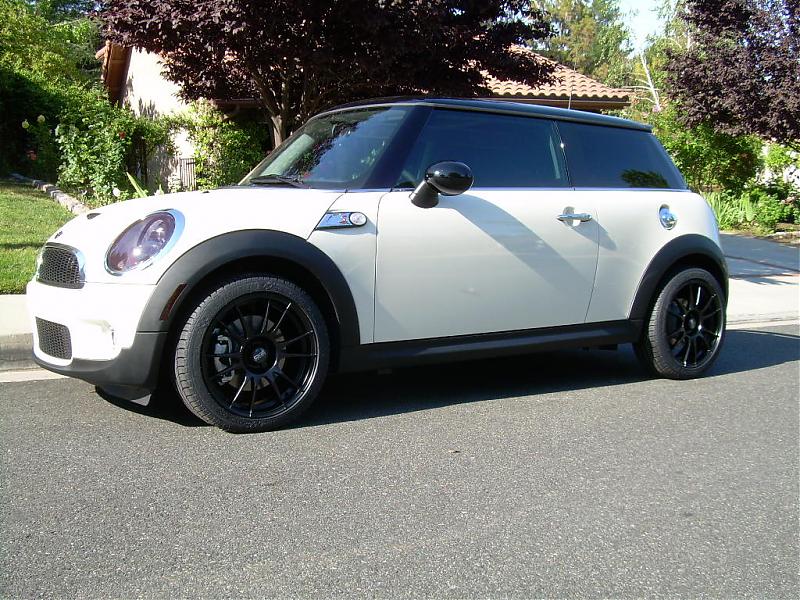

Here it is, so far.....
Can anyone recommend tire pressures for 205/45 17 Exaltos? 33 psi just doesn't feel right.....

For spirited driving on dry pavement, try running them at 36-38. You can differentiate between front and rear to try to fine tune a neutral steer.

Evil?? Nawwww. Unless you glue horns and a tail on your MINI... They're just toooo darn cute!

Black out more chrome
to get the evil mini look. And I run higher pressures... 36-38 cold for street driving.

H&R springs to lower it might make it look .........(of all the non-pc things I tried to come up with, I decided on).....Lower!

Do you both mean 36F & 38R ?
About lowering....this will be my daily driver (25,000+ miles per year, almost all highway at high speed, if you look at my pics, you'll see the Porsche in the garage). The Mini looks very rally-like right now (high wheel-well clearance) and it would be nice to lower it, but I don't want to do radical springs and shocks. Someone told me H-Sport (?) has/will have springs that will only do about 1" ? Maybe those will ride stock-comfortable and won't necessitate new shocks?

Welcome, and nice 'cute' car!
Ha Ha. Just kidding...
What about adding lights to the front for a more agressive look?
Just a thought!

Congrats, looked at your gallery, nice PW and nice first pictures.
Black out everywhere, lights, beltline. Put darker film (but legal) on your headlights. Lower it one inch, ride should stay about the same if you use a good set of lowering springs, H&R are rated very good. This will give you the evil look, but why? If you were going for the stealth look with subtle power, then...
Not sure what tires your running, the orig. Dunlops runflats are harsh. If you put on an excellent summer performance runflat you will enjoy your 25K++ yearly commute miles a lot more. I currently only have 900 miles on my R56 and I'm thinking the RFs have to go.

I use 36 to 38 depending on a lot of things, but numbers around there for the street seem pretty good for me. Also, I'm running 215-45s Goodyear GS3Ds. If you run a 215-40, make sure you keep the pressure a bit to the high side...
Also, on lowering, I wouldn't go much lower than 1/2" to 3/4". As you go lower than that, the front control arms start to go into a bad angle. Also, the Mini has very little suspension travel, so if you start to lower, be ready to loose some fillings when you hit big bumps, and the mushroomed strut towers won't be far away. If you're going for a track car, then much stiffer springs can make the suspension travel issue go away, but the control arm geometry is what it is. Less a sawzall and welder, that is.

It depends on how your suspension is set up. Try that configuration first. If it is under steering raise the front to 36. If over steering, you can try another pound or two in back.
