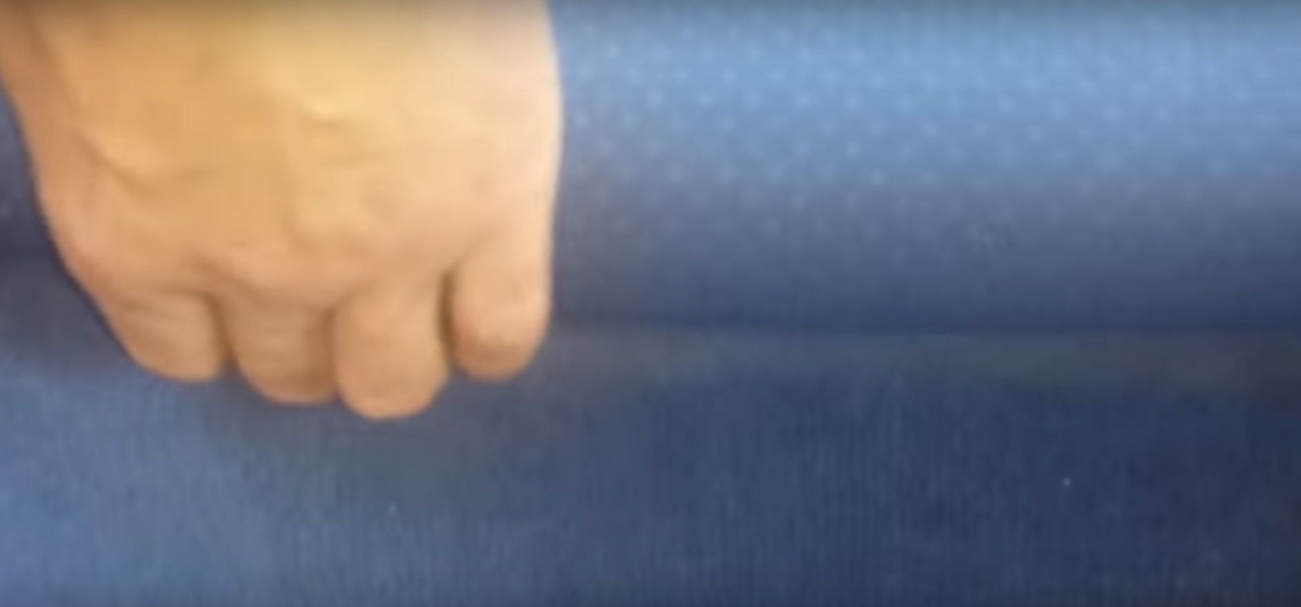

Most 1st generation Mini's have a hatchback release cable; though, the first year and a few other models are lacking one. To access the hatch release cable, lift up on the bottom cushion of the rear seat on each side until it pops free from the retention clips. Pull the cushion up, and in front of the middle seat belt anchors, you will see a cord with a round loop at the end—this is the manual hatchback release cable. Pull forward on the cable and you'll manually release the hatchback latch, which will allow you to access the battery under the floor of the cargo area. Once you are done with the hatchback and battery, push the seat bottom back into the clips until they lock in place.
Figure 2. Pull up on both corners of the rear seat bottom to release it from the retention clips, then lift the seat bottom up.
