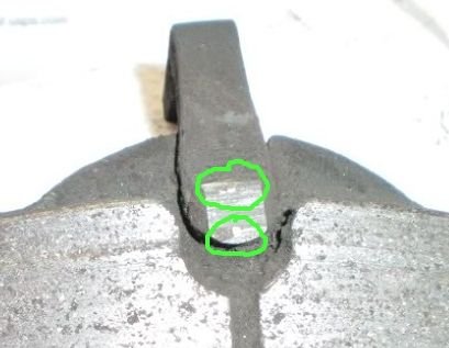

I've dissected one ... the two stage is a myth ...... there's one loop of wire .... period ... there ARE two different systems: the miles counter and the physical sensor.
I too have found the miles counter to be WAY off but you can simply reset that one .... a triggered physical sensor on the other hand is only cleared by replacing the sensor (or jumping it out of the system)
I cut mine off too .... they are useless if you do ANY of your own work ...... simple tire rotations allow you to check pad wear all around and a kwik check can be done without even removing a wheel
when the pad material is thinner than the back plate you need to get thinking about new pads.
this is a worn MINI pad and I put some white on the backing plate ... note the pad material is just about as thick as the backing plate
here's an almost new MINI pad .....
A couple of 'kwik check' hints ...... if you look closely at this good pad and compare to the worn pad you'll see that the 'bevel' ends just about the thickness of the backing plate (did I manage to explain that?) ...... in other words .... IF you can still see 'bevel' you're cool . . ... ...
