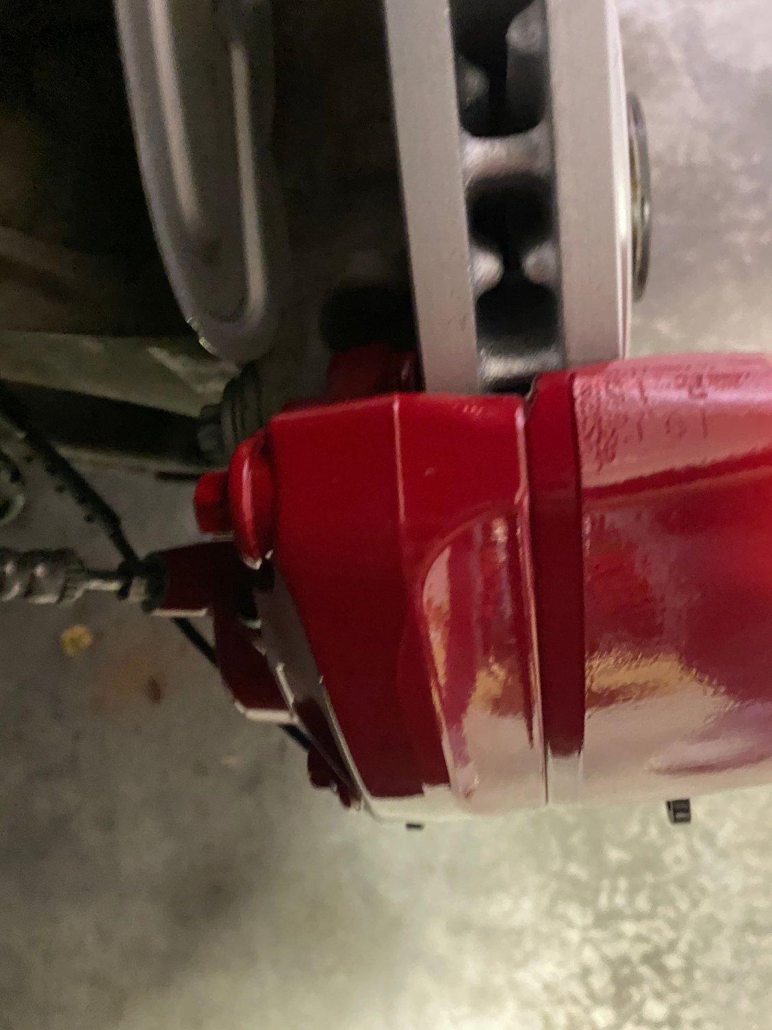

Getting ready to install these and wondering which side to start when bleeding. Each brembo caliper has 2 bleed points, inside and outside.

well started tonight. Took about 2 hours on the front left. Front right should only take about 1 hour tomorrow after I have figured out what tools I needed. Prod do one rear tomorrow after the other front. So far so good. I’ve never bled brakes before so that should be fun when all done installing. I bought a power bleeder. Looks easy enough.

Did the other front today. Took right around an hour. That was jacking car up and taking wheel off and back on when done. Makes the neuspeed wheels look much better. Not a lot of room between the caliper and wheel. Bit more than a quarter. I guess that’s enough. Wheels said the cleared the JCW brakes.

FYI: My factory wheels/brake only have 5mm caliper/wheel clearance, less than 1/4 inch.

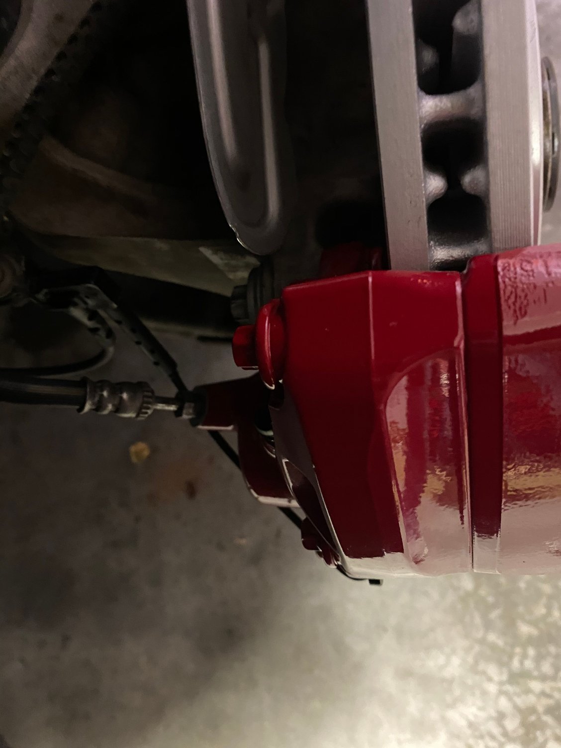

Well finished the rears and bleed the brakes once. I have a spongy pedal. I can pump it up and it holds but as soon as I release it spongy again. I’m going to re bleed tomorrow. Mybe try the old fashioned way. Any suggestions would be great.

Ok so after I couldn’t sleep I got up at 4 and re bled the brakes. I did the brembos inside out. Everything is good now. Took it out at 5 to bed in the pads. People prob thought I was crazy with the stop and gos. This was the first time I’ve ever tore brakes down and installed new. Done pads before but never cracked open a bleeder valve. I’ve always been intimidated by brakes. No longer. That was pretty easy and the power bleeder works great.
