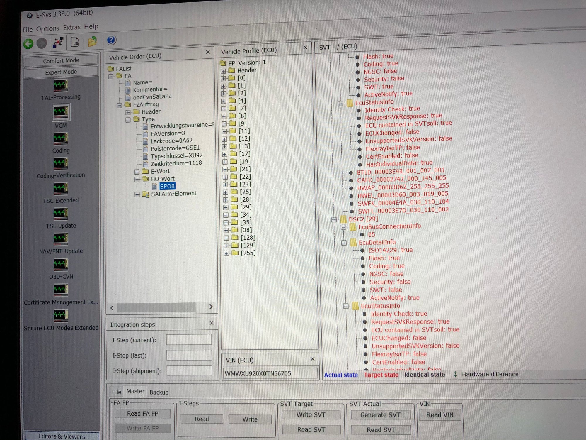

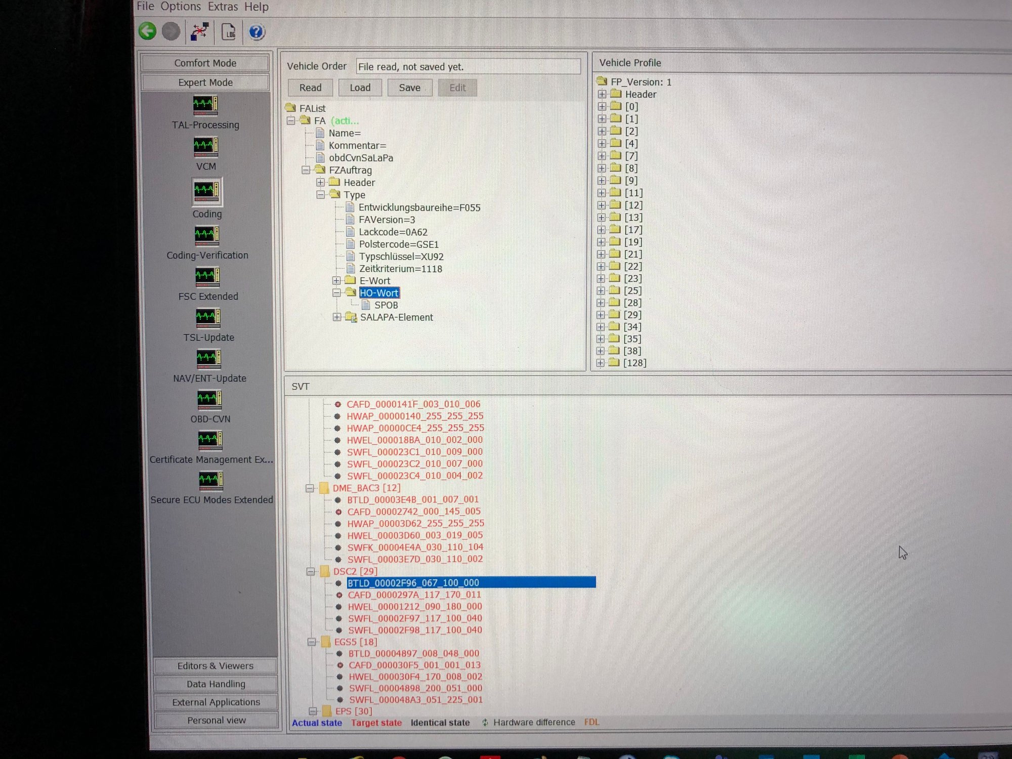

Hi, I’ve manages to add SPOB to FA and code the VO. But I can only find DSC2 in the list and cannot find anywhere to change the disc size. I’m using Esys 3.33 with Psdzdata 4.22.32 Lite.
Tq for any input

Ok after some poking around, I managed to read the coding data from DSC2 and generate CAFD file. But when I tried to Edit FDL, I got an error “est file not found”. Any ideas?

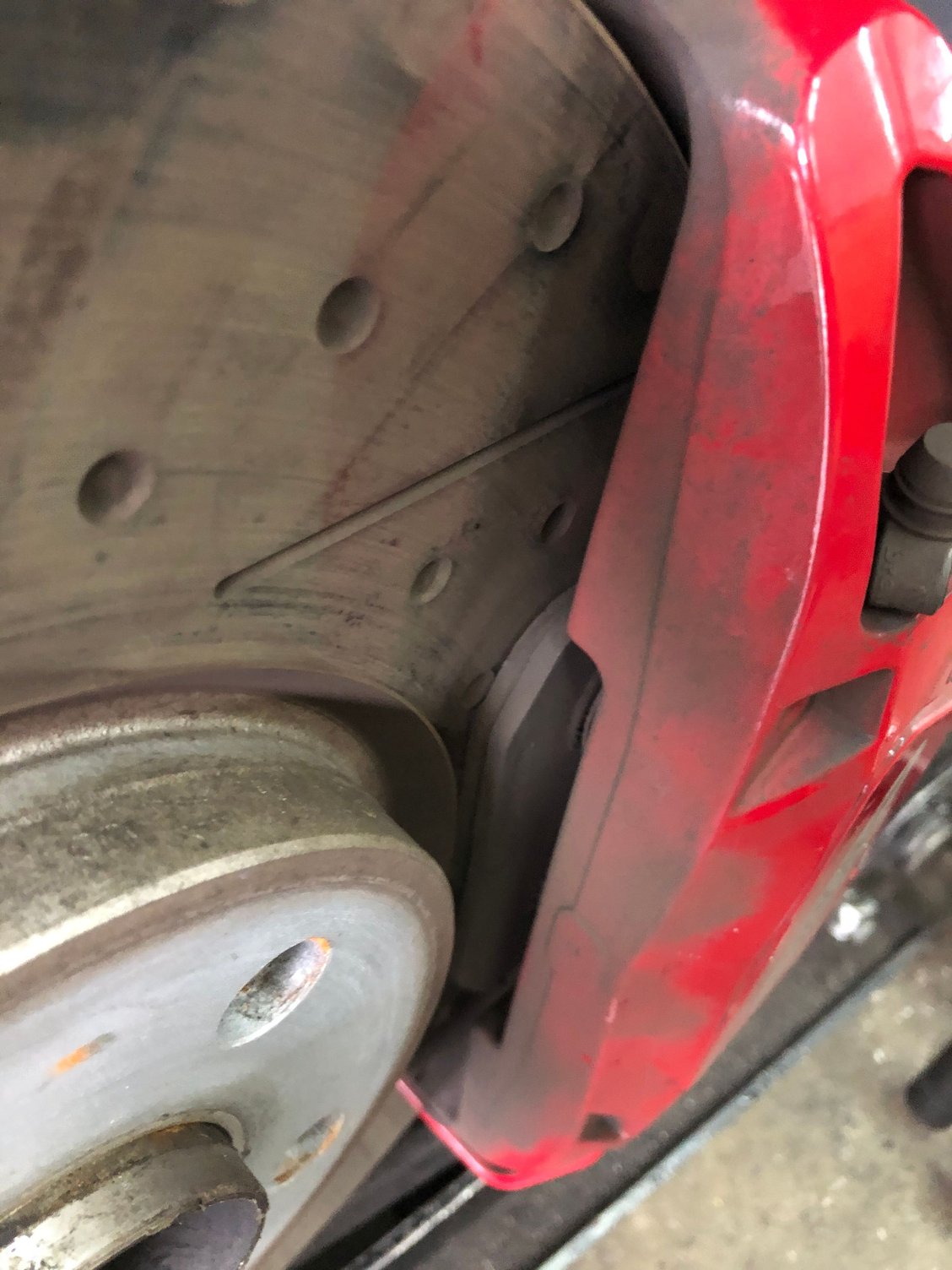

Hi, this is the condition of my brake pad after 5K miles. Seems like the wear rate is quite high. How much mileage can you get from your original pad?
Tq

I would have to say that is 'excessive' wear for 5K miles...unless those are on track miles? Were those rotors new 5K miles ago, since I see a pretty good lip toward the minor diameter of the sweep area. Another question that comes to mind...Are you a 2 footed driver (i.e.- resting left foot on brake)?

No track just normal toad and I’m a single footer. The disc has no sign of wear. The lip is an optical illusion/reflection..

Changed my brake pads today. The wear is uneven, more on the outer side. On the inner side, one portion has higher wear. The pistons are not sticking. Wierd..

The inside/outside wear is pretty common, even on non-MINI vehicles, it has to do with how the caliper 'slides' and how well the piston releases pressure from the inside pad. The inside pads typically get more wear being against the caliper piston. Also, don't forget that the calipers can slightly 'twist' on their slides, which can cause a taper wear pattern in the pads as well. I don't see anything truly 'out of whack' with the pad pics above.

I’m using a fixed 4-pot Brembo caliper, so the caliper does not slide/twist like normal floating caliper.

Ah, had it stuck in my mind that those were the rear pads, sorry about that. In any case, the side/area that has more wear is where the pistons are not properly retracting back into the bore. I know you stated that the pistons are not sticking, but I would have to disagree. The amount of sticking may be minimal, but they are not retracting and keeping the pad against the rotor, that is the only way the pad can wear. Over time, the piston seals harden which increases the 'stiction' of the piston. As your pads wear, the pistons also protrude out of the bore more and any moisture that gets into the boot can cause corrosion on the piston's outer wall. When you go and put new pads in, the pistons have to be seated back fully into the bore and any surface corrosion/contamination will also increase friction between the seal and piston. Caliper pistons live a 'rough' life and need regular maintenance and/or replacement, it is just a fact.
