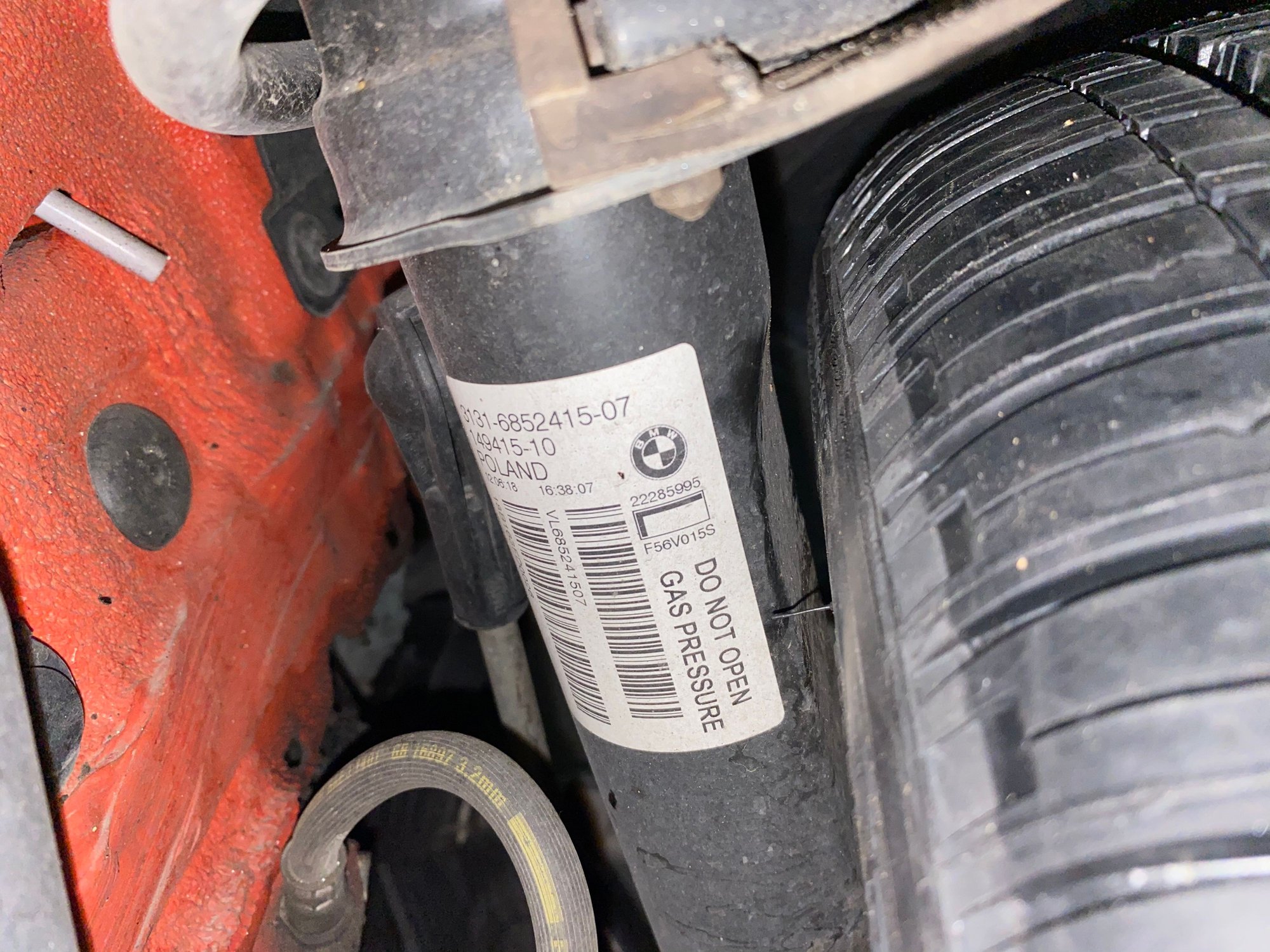

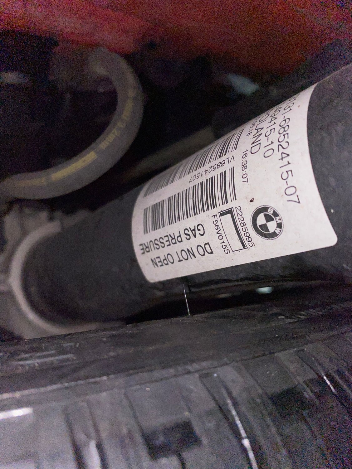

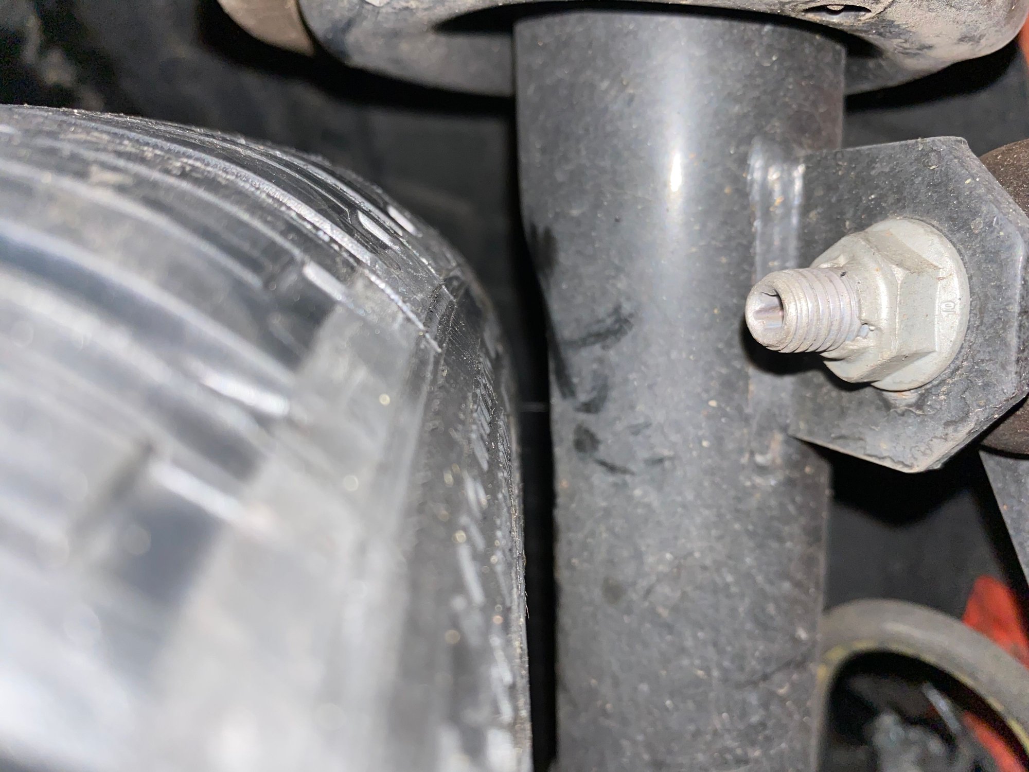

Michelin primacy mxm4 rft 225-40-18 on Enkei ts-10 18x8 et45
2019 F56 JCW stock suspension. Clears the brakes, no spacer. Clears the front suspension too which I was more worried about. Rear has plenty of clearance. Posting this to inform people searching for the same setup ( sticking with rft, 18x8, what offset, will it fit). Just passing it forward as everyone else has helped me immensely from their past posts.

Car is an F56 JCW? Might also want to mention the wheel brand in here: Enkei Tuning TS-10
Looks good on the suspension side. Any pictures of the brake clearance? What does it look like at the fenders? Still on stock springs?
