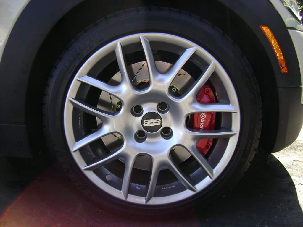

The biggest difference in the 2 kits is basically how they were designed by both Mini and Brembo to work with the Mini. Similar to the SRT8 brakes or Subaru STi brakes, the manufacturers, since dealing with warranty on these, want to ensure they meet expectations on things like life span, pad life, noise, dust, servicability at dealer level....which you would expect from an OE product. The GT system was designed by Brembo for performance as the main target.
With either kit you don't have to worry about launching the MINI end over end, as factory balance/master/abs have been factored into both kit. We just installed the Brembo kit on our '08 MCS on Friday night, haven't really beat on it yet, but so far so good.
also, running 17" BBS with plenty of calip clearance. not the greatest pic, but it's a quick one i just snapped.
