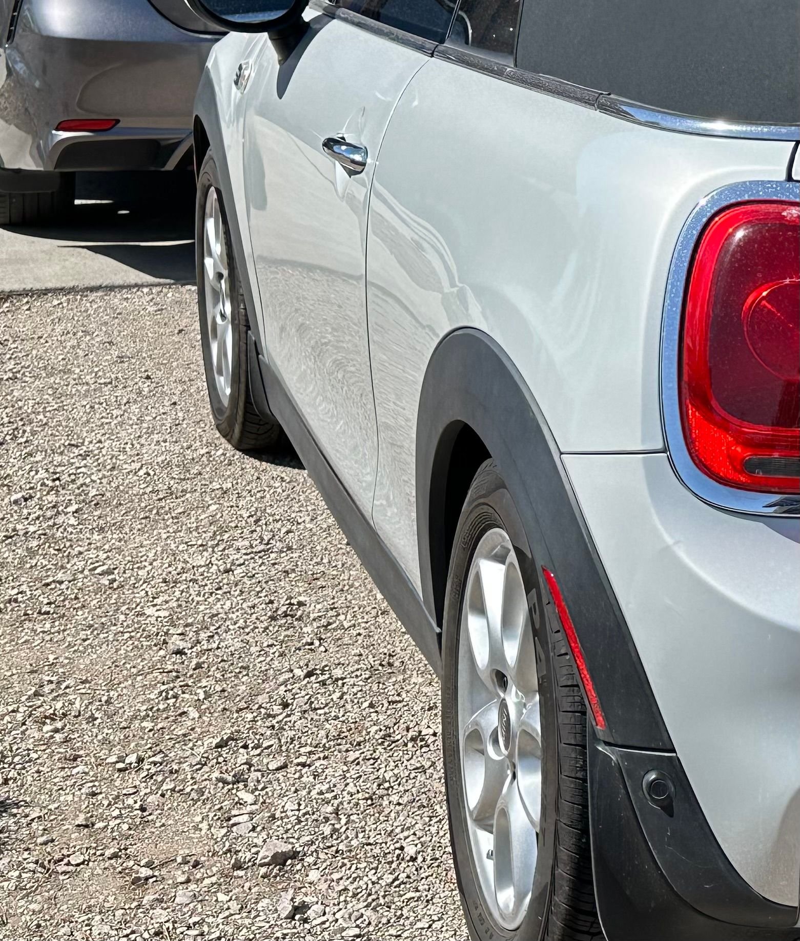

205/55=16 on stock wheels
My 2018 has this size tire on the stock wheels, they were on the (pre-owned) car when I bought it last year. No rubbing noted, I am possibly considering a 12mm spacer to widen the track a little as I don't want to buy new wheels and tires at this time. The tires are Pirelli and NOT run flats.
