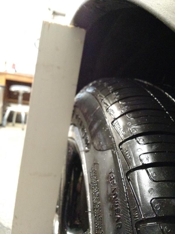

I was looking to put spacers on my ALL4. It is stock including 18" wheels and 225/45/18 Continental runflats. It definitely does not have that wide stance that my 03 MCS has with 17's. But, when I measure in accordance with the ECS method it appears MINI did a fine job of maximizing the stance to fit the wheel well.
Of course this assumes the wheel will travel directly in upward and not swing inward on compression. I guess I will hold off on spacers and put that money toward something that WILL make my Countryman handle better, an upgraded rear sway bar.

That's pretty flush as is (especially with that HUGE lip MINI demands on using on these cars. Seems much better than the offsets used in past Countryman. Maybe my eyes are playing tricks on me though. Is that front or rear?

That was the rear. It is also a little deceiving because of the angle of the camera. The front was about the same. I've only had this MINI for a few weeks, but have logged 3000+ miles. With the current offset I also get quite a bit of crude being kicked up on the side of the MINI by the front tires.
Another thing to note is the roundness of the treads shoulder. I am running Yokohoma S-drives on my '03 and the tread width is almost as wide as the rest of the tire. Not so with these Conti's. I think tire choice also helps fill the fenders and the appearance of a wider stance.

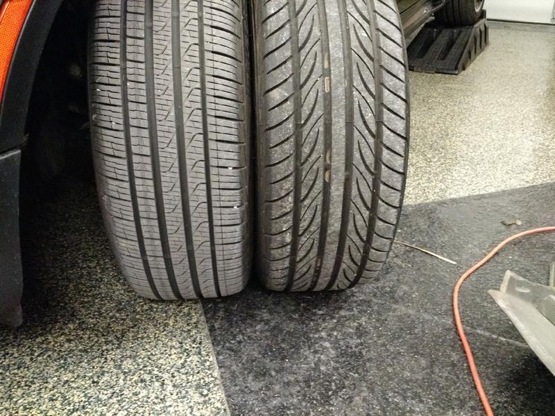

I have stock 5-Star double spoke jet black 18"x7.5" two piece wheels.
I took this picture for comparison.
The tire on the right looks much wider, but it is not by tire size. The tire on the left is my stock Perrilli P7 225/45/18. The tire on the right is a Yokohama S-Drive 205/45/15 off my Alfa Romeo Spider (on 15"x8" Mustang turbofan wheels.) I had the same Yokohamas on my '03 MCS in a 215/40/17 and they looked VERY wide on that car. The S-Drive is a great summer tire.

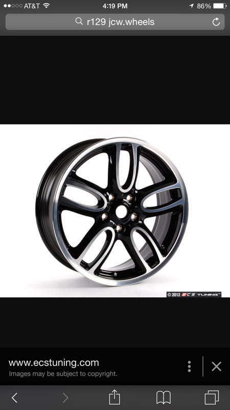

Posts: 36,762
Likes: 2,551
Originally Posted by wzabrouski
I really like these wheels : look awesome in person. 36116798503 Little GP ish.
