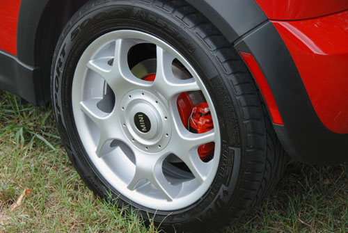

I decided to also paint the middle of the rotor (the hat part I guess). As soft as the stock rotors are, I figure I'll be replacing them soon anyway, so if I don't like the red, I don't have to do it next time.
But it is growing on me.
