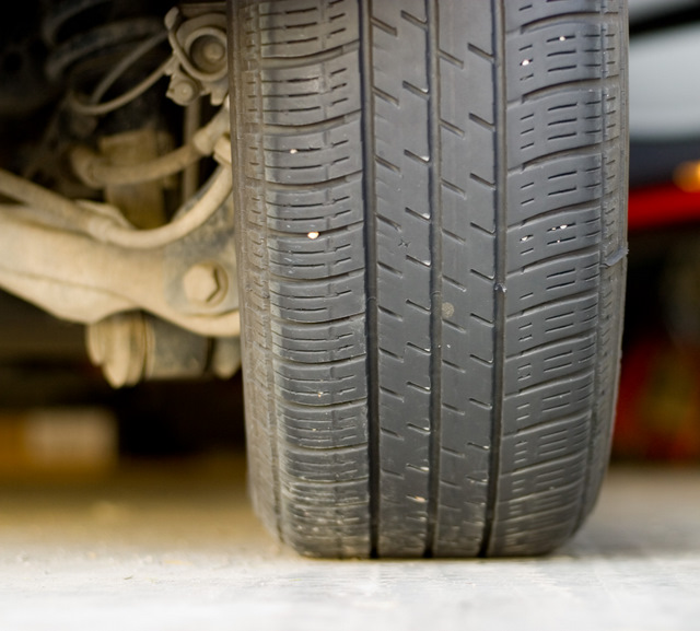

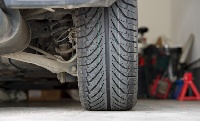

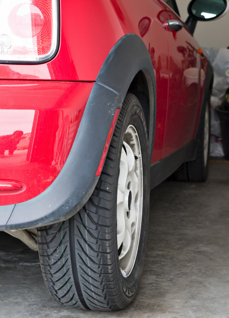

Old Oct 8, 2006 | 08:46 PM
xtremepsionic's Avatar
xtremepsionic
Joined: Jun 2005
Posts: 557
From: Calgary, Alberta, Canada
I ran the 175/65/15 contis since new, and replaced them at 21000kms. They were pretty worn out, maybe 25% tread left til the wear bars.
I replaced them with 195/55/15 Kumho 712s because they were dirt cheap, I got the kumhos, plus mounted a set of winter tires I have on another set of holies all for $380 CDN, so that's 4 new tires and 8 mount + balance
In terms of grip level, these Kumhos are a bit better than the 175 Contis. I have a g meter in the car, the Contis usually tops out at about 0.83g or so. By that I mean they would be squealing and sliding, giving up grip. The Kumhos, after running them in to remove the initial non-sticky layer, can manage about 0.88g before they slide and squeal. So a noticible difference, but not massive.
The biggest change is definitely in terms of sidewall flex. The 175 contis' biggest weakness is the insanely flexible sidewall, they are way too soft. I tested it by rocking the car, pushing the roof and see how long it takes the car to settle down. The 175 contis would take about 10 occilations before it was all still again, the Kumhos took about 5. This translates to a really different handling feel on the road. I drive very aggressively usually, I normally take corners at above 0.7g, and the Kumhos are way more stable to drive fast with. The faster the speed, the bigger the difference is between the two tires. The 175 contis would feel very unstable cornering at 90mph even at just 0.5-0.6g, the tire sidewall flex makes the car feel kind of soft and bouncy, and wouldn't settle down in a nice way quickly, the Kumhos are way better.
At the limit and just over, the Kumhos would just slide progressively, although this was after I tweaked my front and rear tire pressures to 40/36psi, and I used chalk to confirm there is no rolling onto the sidewall, only slightly touching the rounded shoulder part of the tire during maximum cornering. The 175 contis would scrub and squeal more before they give up grip, which is safer, I suppose. However the contis would scream for mercy starting at a low 0.74g or so, while the Kumho 712s would only squeal at about 0.83g, so less of a "squealing" window.
Another difference is that the Contis didn't seem to grip enough to allow the suspension to fully set, therefore my rear sway bar mod (18mm H&R) didn't have as much of an effect as when I have the Kumhos mounted. I could get a lot more rotation in the rear if I lift off the throttle mid corner with the Kumhos than with the Contis. I think this is mostly because of the reduced grip level of the contis.
The plus side of the contis is that they do give slightly better gas mileage (about 1-2mpg better overall), and also steering feel and the way the car tracks perfectly straight is very good. The Kumho 712s follows the road camber a lot more, and the steering feels a bit dead on center. However, in the ride department I actually like the Kumhos better, I think that is because the Contis were flexing so much that they felt like an uncontrolled spring, which makes the ride somewhat gittery every now and then. Although big bumps are handled better with the bigger side wall of the contis.
Just as a side note, I also have a set of Kumho V710 slicks 205/50/15 mounted on holies. Those don't flex at all pretty much, same rocking test I did by pushing the roof, these settle down in 1 cycle, very stiff sidewall. The grip level is way higher, up to 1.05g max that I've seen, and probably even more than that when properly warmed up. I also get a LOT more oversteer with the slicks when I lift off, much better cornering attitude control with the throttle with more grip I think.
Do I recommend the Contis? Sure, I think they do provide enough grip for street use for almost everyone, you can go faster with a stickier tire, but you're talking about some quite illegal and frankly, a bit dangerously fast speed here for street use. They ride nice, handle well, great pure steering feel, and worked quite well for the snow I got here in Canada (while the tread was still deep anyway). The downside is that if you do like to drive aggressively, they just don't feel very confident or encouraging, especially at higher speeds (60mph +) They also get quite noisy below about 30% tread left, and hydroplane pretty badly as they wear down.
Personally I feel that 195 is quite wide for the Holey rim at 5.5" wide. The steering already feels a bit wooden at this width, and 205 just won't give you that much more grip, plus the sidewall will be buldging out from the rim quite a bit, which might not be the best thing when you're cornering hard. I'm not sure what the effect will be, but I imagine this would put more stress on the sidewall and might not give the contact patch the optimal shape in that circumstance. I do not feel any change at all in terms of acceleration with the 2.2% smaller overall diameter of the 195/55/15 vs the 175/65/15, nor did I notice much difference with the 205/50/15 either. I suppose the shorter tire do accelerate faster, but not really enough to be felt. Yes I do get better 0-60 time according to my g meter thing, but a few tenths here and there doesn't mean a lot to me (that's why I can happily drive a Cooper and not crave for an S, I'm all for handling)
In the end it is always your choice, and what is the best thing avaliable to you at that moment. For me I am quite happy with the 712s at 195/55/15, and I recommend that you spend some time tuning the tire pressures for whatever tires you choose, it does make a huge difference.
The pictures below are: 1. 175 Contis at about 30% tread left at 18000km. 2. Kumho 712 brand new, sidewall view 2. Same tire straight on view.
Attached Thumbnails 17" s-lites v 15" holies on a Cooper-aug12_3301.jpg   17" s-lites v 15" holies on a Cooper-sep20_5003.jpg   17" s-lites v 15" holies on a Cooper-sep20_5006.jpg
