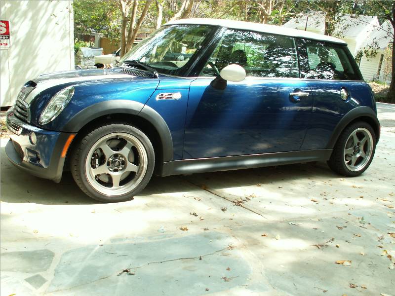

Until I learn to take better pictures, these will have to suffice......

Hey Skip,
They look great! Did you lower your Mini, or is it stock height?

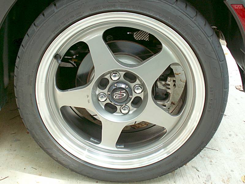

Here are Toyo Proxes T1Rs 215/40/16 on Rota Slipstreem 7x16 45 over Wilwood 12.2" race brakes. The rear are Powerslot Cryos.
Wes
