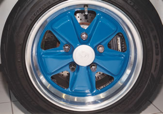

Hmmm . Not quite my style , BUT it does make me think of the colored wheels that Porsche used on the early Carrera, where just part of the wheel was painted. I wonder if there's a way to do something like this, say, on the S-Lite ...
