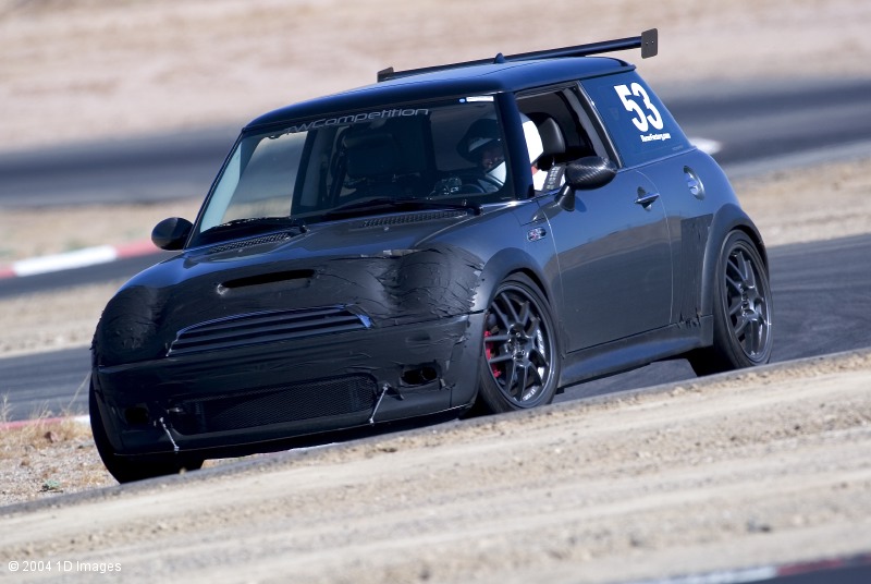

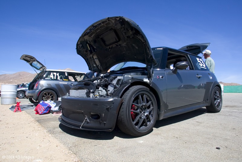

Ro-ja does not supply the spacers unfortunatly. Any good aftermarket tire shop should be able to set you up. I have access to a close out for the ro-ja lt 5's if anyone is interested. 17/7 42mm offsett 14.5 lbs. Have white , silver and bronze left. Normally sell at $ 340 per wheel I can have them delivered for $600 a set. PM me if interested.
Randy
M7 Tuning
Attached Thumbnails Bought 17" wheels... Do I need anything else?-willowmini1a.jpeg   Bought 17" wheels... Do I need anything else?-willowmini3.jpeg
