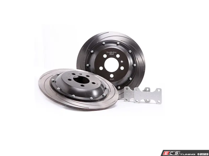

We just loaded up tarox and they have some options now.
https://www.ecstuning.com/b-tarox-parts/v-mini/
