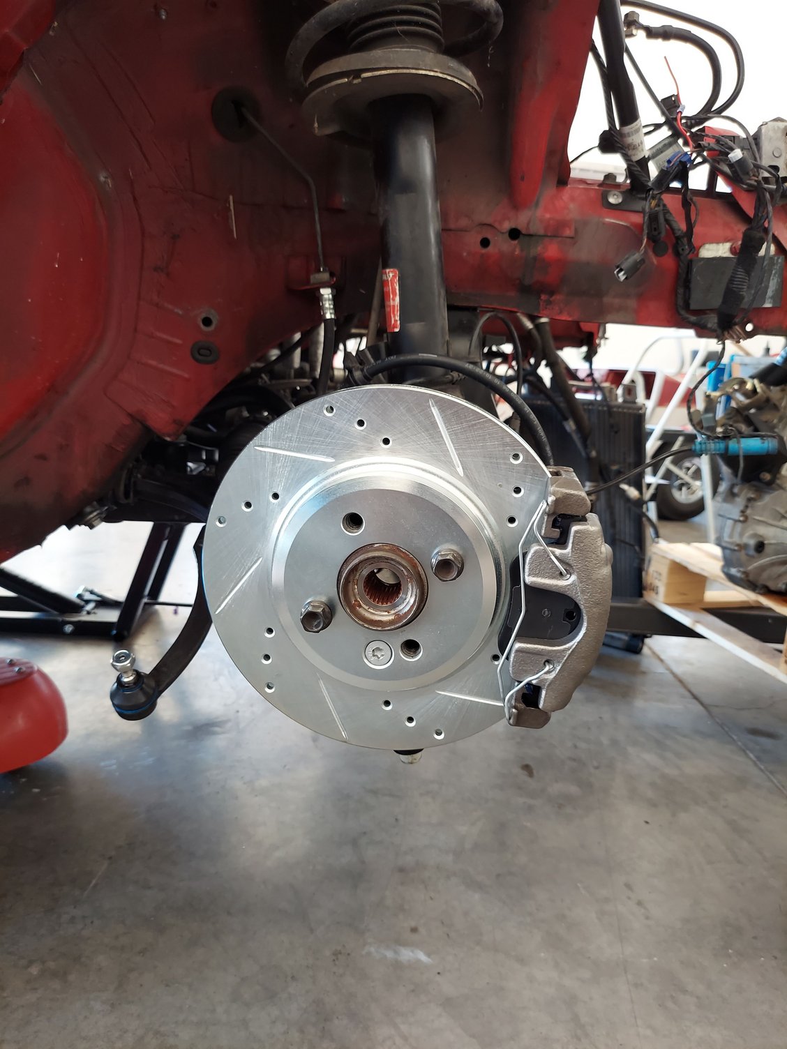

Awesome ! Did you do r56 front too ? What is your opinion on the extra braking they added ? I know my next mod...i just cant believe how much r53 brakes suck. Imo theyre not even good enough for stock power levels.. imo , the area i prefer overkill is brakes and suspension as you can tell with my car..if these r56 brakes arnt adequate for me and my car then I know my next step but unfortunately it's going to be expensive so that's why I HAD TO atleast try the r56 swap.
I got these today though.
i had the decals because i was going to do brembo rotors and pads but I think the ebc setup will be fine.. I might throw the decals on the calipers to fib after I paint them if it looks nice.

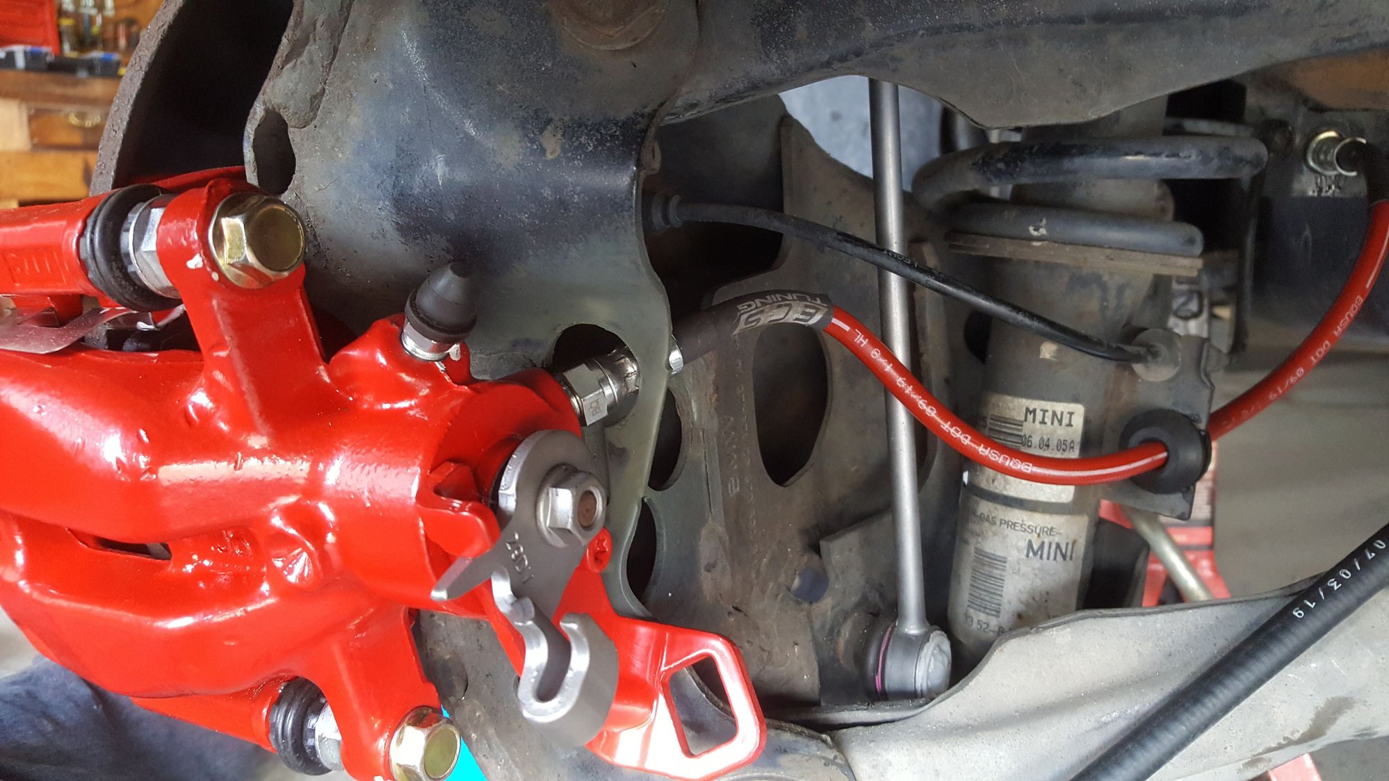

When I upgraded my R53 brakes, I used 294mm R56S front discs and calipers. On the rear I used stock size discs, R56 brackets and persuaded some 38mm audi calipers to fit. EBC red pads all round. If I did it again, I'd just slap an entire R56 justa set on with EBC reds. My upgrade is actually a bit much for road use, makes 15" wheels tight on the front and it was a pain to find and fettle 38s for the rear. Brake balance was near stock.
