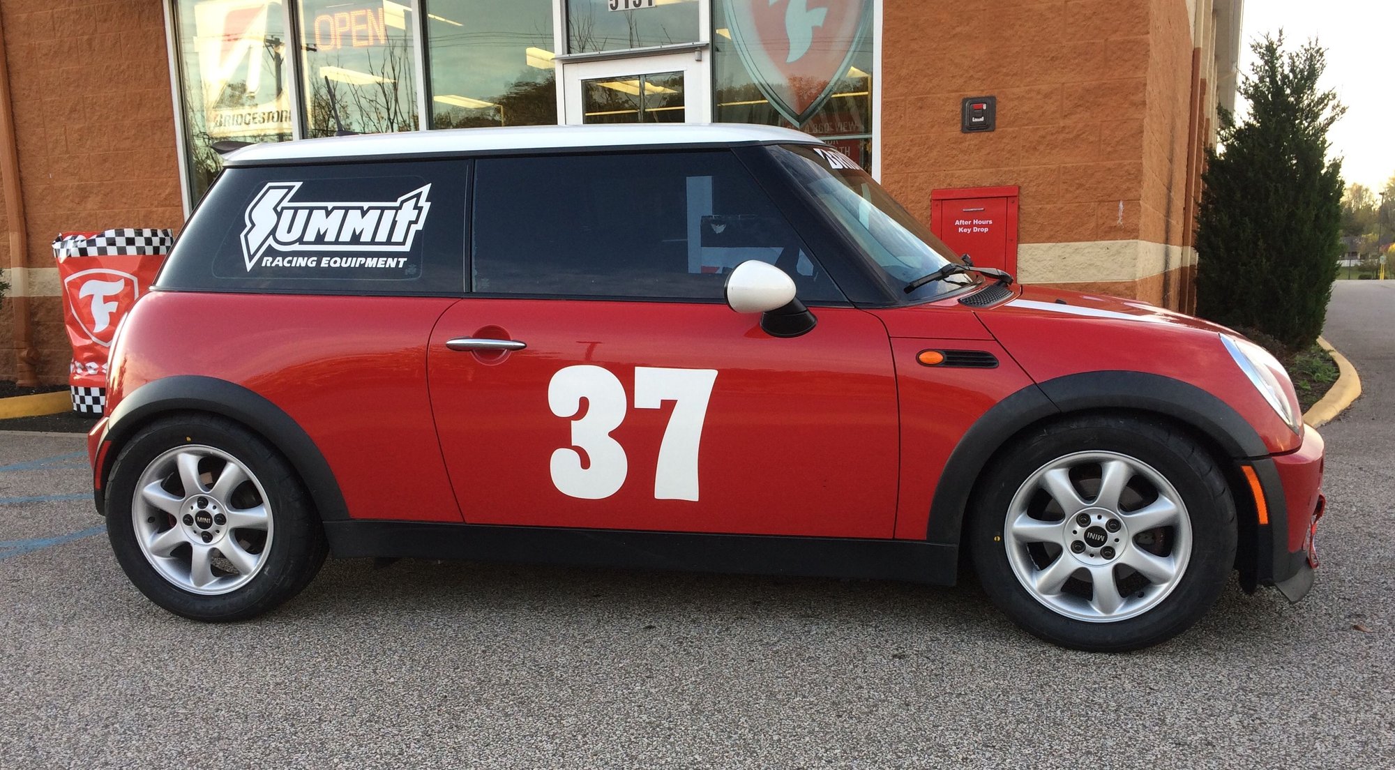

FYI: Tried an experiment, mounted 225/50R16 Firestone FireHawk Indy500 tires on my R50.....just a little too wide! Go with the 205/50R16.....perfect size!
