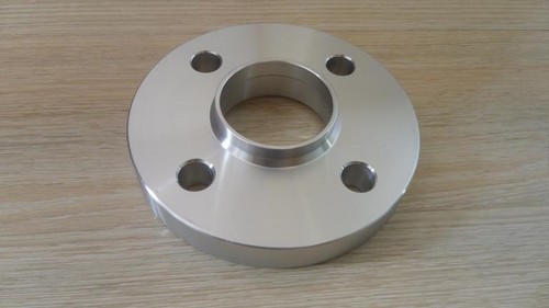

So is the lip on the outside of the spacer the same diameter as the lip on the hub? From the pictures it looks like would be larger, meaning my hubcentric rings would be too small.
Found these on ebay.

that one does not look like mine, mine have a taper on the inside

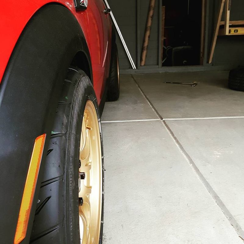

what offset are your wheels? this is mine with 17x7.5 et45 ,235/40, with 15mm spacer. i was worried about clearance to coilovers but it has plenty, 10mm prob would be perfect for me also

15x8 +36, which is why this is a little more complicated than it should be, but I think I'll be happy when I get it all ironed out.

I'm running 15" wheels (because they're 11.6 lbs) so I'm not trying to just be flush, I'm trying to get the wheels to not rub on anything. 5mm spacers in the front and everything clears, but 5mm in the back and the wheel rubs on the bottom of the control arm where the bottom shock bolt is. 8mm wouldn't give me enough to be comfortable, 10mm would be ideal for the stance, but I understand now why there aren't any 10mm spacers out there. I don't really want to go with 15mm spacers because I feel that will be too much, so I'm hoping "randeez" has good luck with the ones he linked. If not, I'll get 15mm spacers and call it a day. WMW got back to me today, the stud conversion kit is safe for 15mm spacers.
