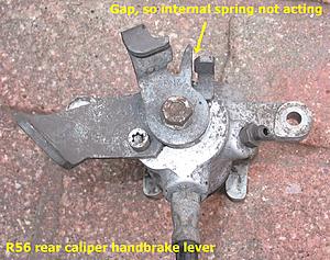

Has anyone removed the hand brake levers from the rear of the R56 caliper? How do you un-tension the internal spring?

I,ve answered my own question. Once I had removed the caliper and cleaned it up a bit, a gap became apparent.

If you didn't get an answer I was going to suggest you post something in the Gen2 section. Glad you figured it out.
