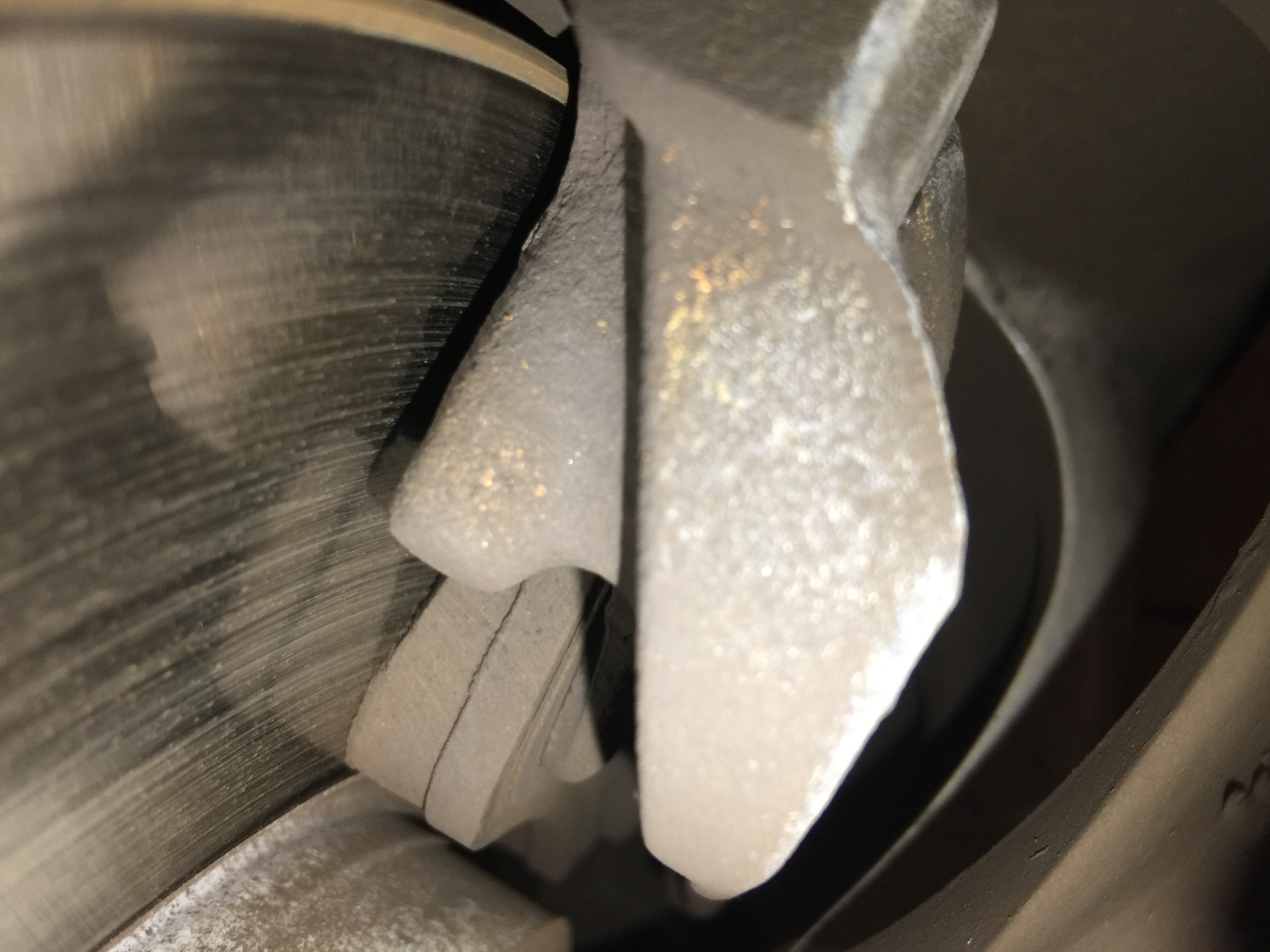

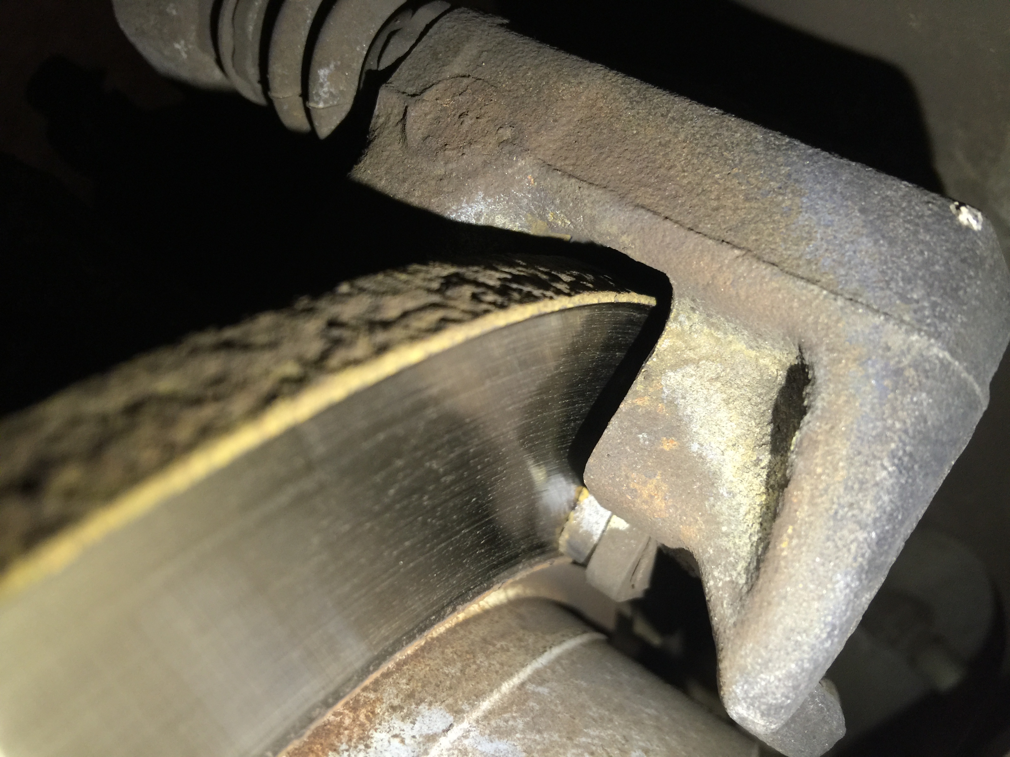

Hi all,
I've got a 2009 Cooper S (Horizon blue w/ white roof, stripes and mirrors ).
My brakelight recently came on and as this will be my first time replacing them, I need some guidance. I've found videos and guides on how to do the replacement itself, but I need help identifying which pads are the issue.
The front pads look okay to me, but the back pads look like they're just about gone. It seems odd to me, since I know the front pads will wear faster (though I think they were more recently replaced).
Can anyone of you wise Cooper owners tell from the pictures? The first two are of the front left wheel and the last one is of the front right wheel. The 3rd and 4th pictures of of the left rear wheel.
Many thanks!

OP ... none of these pictures look critical ... but the rears MIGHT have set off the sensor
did you know that your 9 has 2 systems for monitoring brake wear? There are the physical sensors on the left front and the right rear, and if the sensor trips all you can do to clear the light is replace the sensor. There are ALSO simple 'counters' for miles driven ... one for front brakes and one for rears. These 'guess' wear by your driving habits and count down to zero. At zero a light triggers. First time mine went off for the rears on my 7 I estimate I had 50% of the pad remaining .. the physical sensor had NOT tripped.
SO I reset the counter, the light cleared, and I was good for many thousands of miles. If you try the reset and the light will not clear, the sensor is probably tripped (or failed)
How to reset the counters is in your owner's manual and done thru that lil wonder stalk on the left of the steering wheel.
Rule of thumb .... looking at your pictures: when pad material is thinner than the backing plate it is time to start thinking about new pads ... but you still have time.
