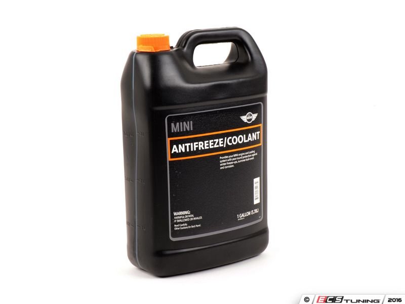

I know I could look up what is required, but I'm more interested what coolant do most of you recommend?

Definitely use OEM BMW/Mini coolant. You can get it from the dealership or online, I always use ECS for OEM parts:
https://www.ecstuning.com/Mini-2007-...B16A/ES196253/
