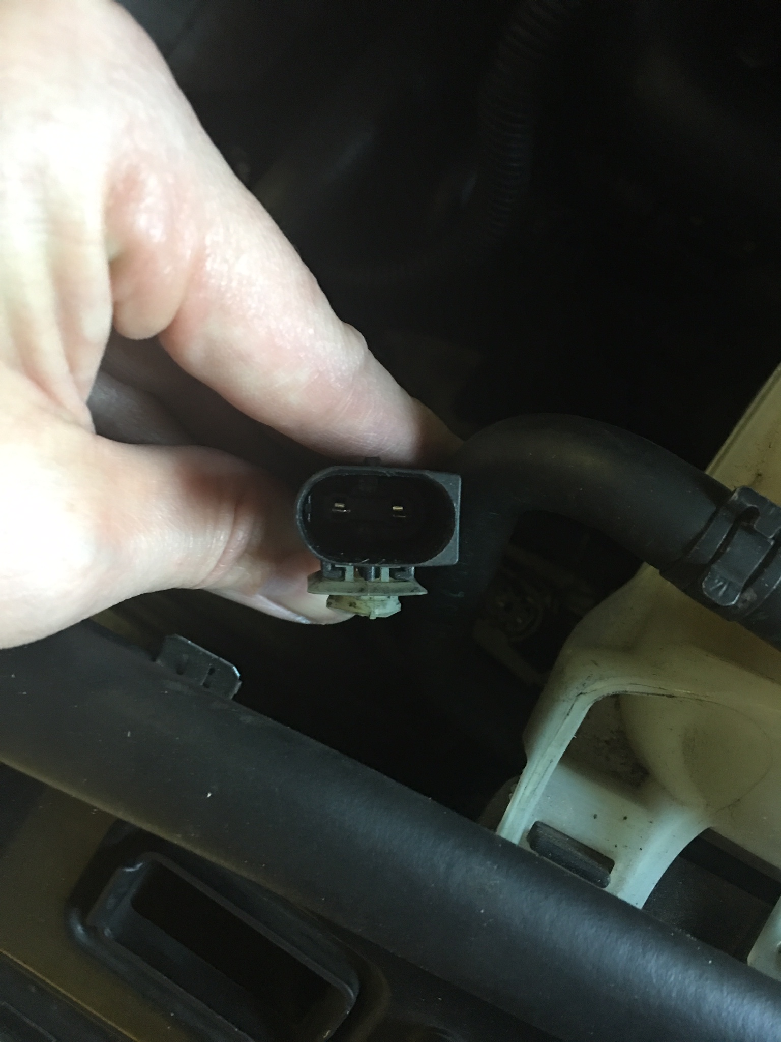

Finally got around to taking a good look at this again today. I replaced the fan relay to eliminate that as an issue. I verified I had good voltage (14.2) at the connector. Absolutely no movement of the fan now. Even tried to give it a little push start for encouragement but nada. Tried jumping it directly from the battery and still nothing. My guess now is the fan is dead. The connector is a 2 wire connector seen below. I'm not thinking I can do the resistor mod as I don't see what is described in the threads I've read (skinny wire/fat wire) and the 2 wires I see run right into the back of the fan. Should I just go ahead and order a new fan?
