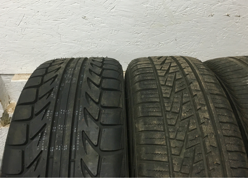

215/45-17 next to a 195/55-16
Question regarding 215/45/R17 Wheels-image-1975994566.jpg

No. No problems. Plenty of people here run 215/45 non-runflats
