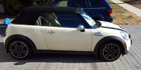

Ok, here's a before and after set of pix with the R83's on the 2014 R57 Convertible S. Guy from ASAP tire came and installed them on-site, took about an hour and a half. Installed with the TireRack TPMS kit.
I took it for a quick spin and they drove fine. Noticed right away there was less road impact compared to the 205/45/17's (which I expected). Didn't notice any other immediate differences in handling. TPMS didn't emit any errors, at least not any I noticed on the console during my quick test drive.
I'll try to take a more 'spirited' test drive over the weekend.
Meanwhile, for anyone searching, yes R83 16" alloy wheels and 195/55/16 Blizzak LMF60 tires fit fine on a 2014 Convertible S that previously wore 205/41/17 tires.
