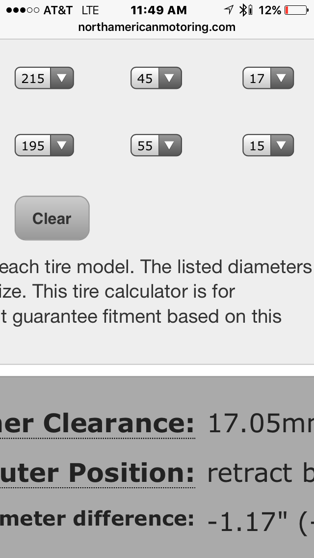

Old Jan 13, 2016 | 08:49 AM
tragedybysyntax's Avatar
tragedybysyntax
Joined: Feb 2012
Posts: 233
Old Jan 13, 2016 | 01:04 PM
Saltysalt's Avatar
Saltysalt
Posts: 2,257
Likes: 15
From: Dover, NH
so that % difference is the difference in your speedo. be aware that the bore on a Miata isn't the same as a mini, it may make it tougher to mount the wheels. but you can get hub centric rings to replace them, shouldn't be a big deal
