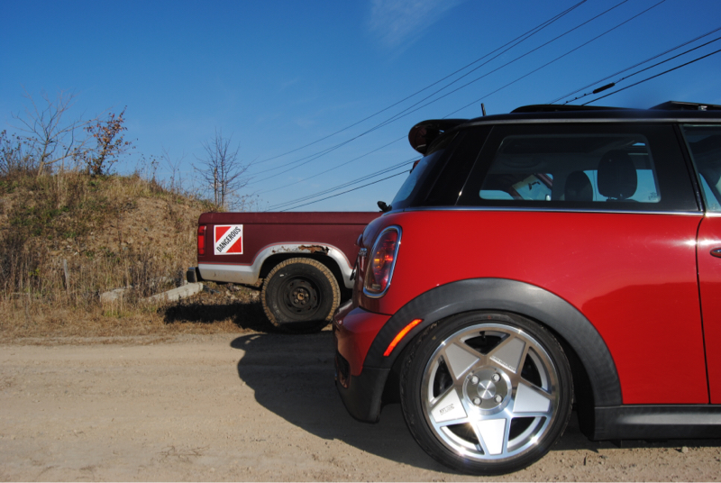

16x8 et25
Lowered 1.75" front, 1.5" back.

Like I said, 16x8. Tires you mean? 205/45

3SDM 0.05 (Yes, "0.05" is what it's called. It's doesn't pertain to any measurement)
H&R Street Coilovers

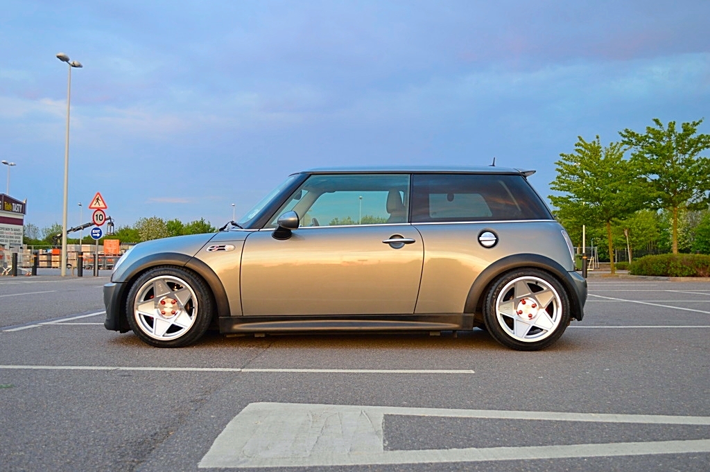

I have 195/45/16 on my 3sdm's they are the perfect size for the 8 wides but very low profile

Hi guys I'm new here and actually from Essex in the UK
I have joined up because I came across this thread when searching for image of the 0.05 wheels on Minis! They do really look great and I've just got to have some lol.
@MNMLST @Nick Royer could you tell me what camber you're running on your rear wheels?
Also, guys over on the UK forum seem to all have 50 profile which looks a little chunky... so it's good to see some 45 business going on! Do you have any problems with your tyres?

Originally Posted by Olly Cripps
...@MNMLST @Nick Royer could you tell me what camber you're running on your rear wheels?
Camber in the back is 3 degrees. At the moment, I'm not equipped to adjust camber at the front, which is stuck 1.7 degrees. I raised the front by .25 inch to avoid rubbing. Other than that, this setup is good a balance between ride comfort, style and performance. And these wheels are fantastic!

Thanks for the reply! Wow 3° really, it doesn't look that extreme in your pictures. I hope you don't mind but I've emailed the above to a reseller I found in the UK for precisely the kind of look I want
It seems you're running standard wheel bolts too? That's good as most I've come across seem to have a stud conversion... not a problem in itself, but it's just added cost innit.
