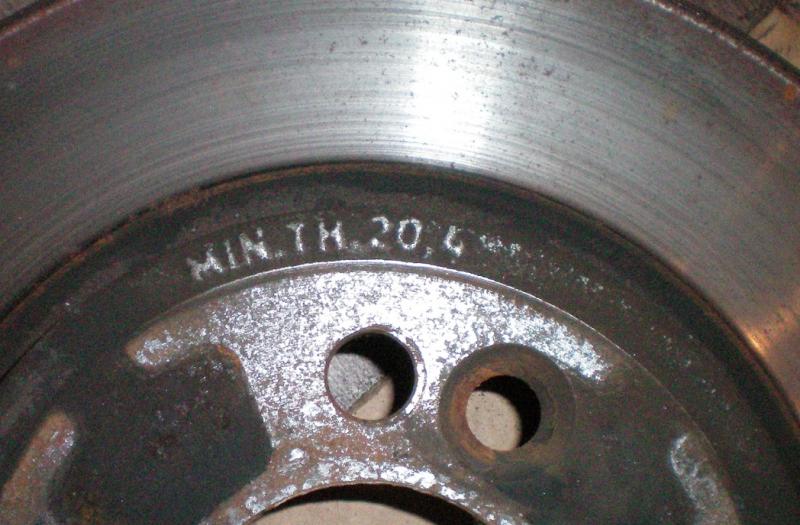

rotor wear is a matter of thickness
minimum thickness is stamped into OE rotors
this is a GEN1 OE front
OE rotors (and pads) wear fast and look BAD FAST ... but may have much thickness left
BUT as mentioned .. basic rotors are not expensive.
I've two sets in my garage folks have insisted on replacing ..... they have at least 50% of their life left ..... make me an offer ..... $1 beyond the Priority Flat Rate Medium Box gets 'em
