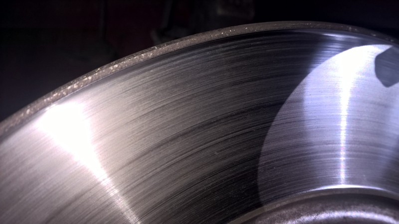

Here are some crappy close shots of my rotors through my wheel:
Rear right:
Front Right:
Rear right:
Front Right:
I can't tell the depth of your ridge but the surface seems average
If this was a first change on MY car (first change on these rotors) .... I'd "pad slap"
