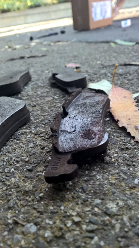

Thanks for all of your input guys! I finally had time to replace the pads. I went with some Hawk HPS's. I followed their instructions on bedding the pads (6-10 stops from 30-35 and 2-3 hard stops from 40-45). They seem to feel really good.
I am glad I replaced my brakes though. The fronts and driver's side rear were fine. But I guess the people who put on the last pair didn't do the rear passenger's side well at all. It had a major ridge on the outer edge and was completely worn through to the metal on the inner. The dealership completely missed that...
