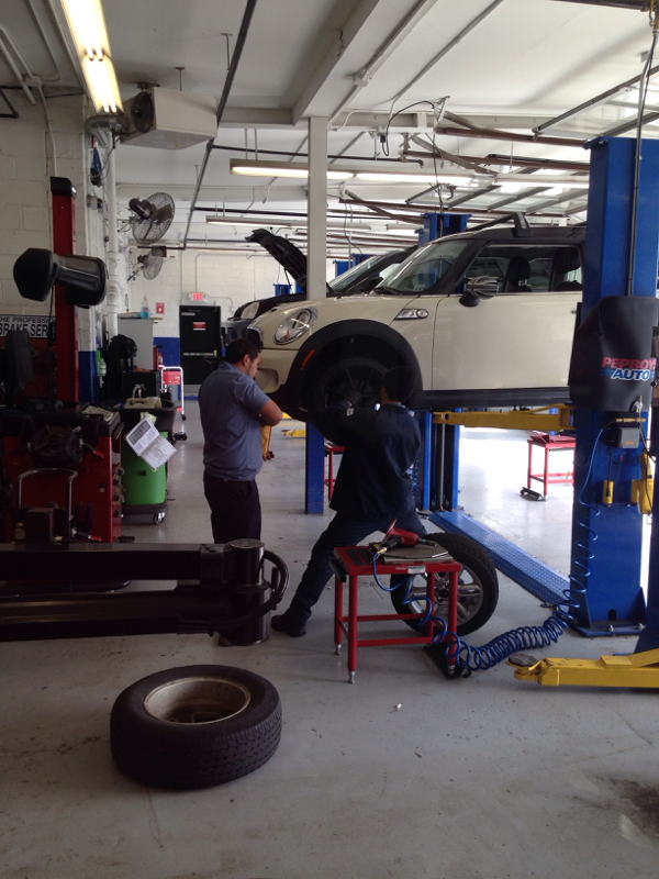

Installing...

I know that may be a stock wheel, but I would NEVER let anyone put my wheels face down.....

That wheel in the foreground wasnt mine thankfully. He did not do that to mine (i watched most of it). Those face down ones were from an hyundai

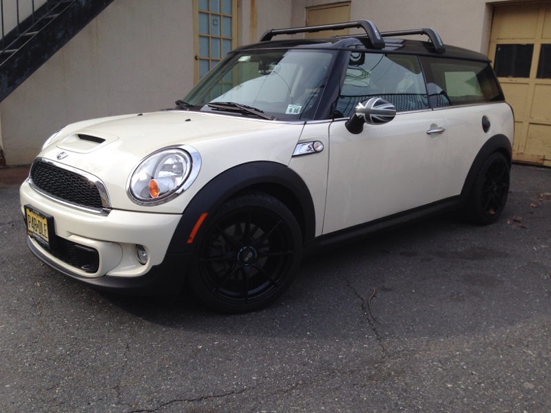

Done

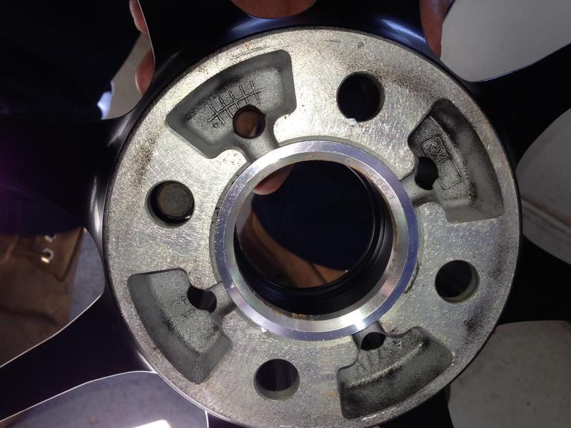

sorry I should have said lug bolts, you are right. The head was too big to fit down into the hole on the rim (the hole for the lug). So they had to send a lug with a smaller head (I think the taper was the same conical one). The smaller head also had to use an adapter instead of the standard wrench. I'll take a pic of the adapter when I get a chance, but here are some pics of the "before" with the oem bolts.
edit: the front pic of the rim has a lug bolt in the top hole - you can see how it doesn't fit down into the rim. The second shot shows the back, and how the bolt can't clear the back to be able to install the wheel.

OK, which wheel did you order?
I hope tirerack now knows about this problem and puts it in their notes on fitment.
Thanks for reporting the problem.
Glad you were able to get it addressed so I guess you are right after all, and the saga continues.

I actually called tire rack the first day I tried to have them installed, and they had to "talk to the hardware team" to verify. So they do know about it now. Looks like they've already updated the website too, because it now shows that it includes the require lug bolts for vehicle.
The wheel is a O.Z Racing Formula4 HLT in black. Love the look. Makes me want to have the calipers painted!
