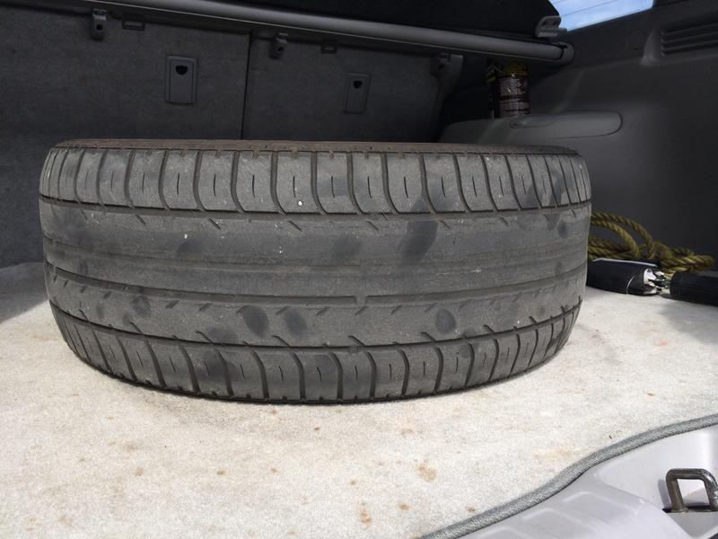

I need to buy new tires. Since purchase, I've ridden on stock Pirelli Eufori 205/45/17 RFTs that have been the worst set tires I've ridden on since I started driving. I have had my 2010 MCS Camden Ed. for 1 year this March and the 2 front tires did not last. I had the right front blow out recently and the left is ready to do the same as the tread wear pattern is the same as the right. About 10K miles maybe slightly over.
