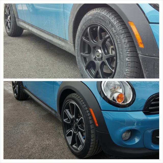

Here they are... stock 17s and new 15s with 195 size tires. Still can't believe how much nicer the ride is. The slight handling trade off is worth it in my opinion.
Raad

big rim and low profile tire = sucky ride
smaller rim and more rubber . . . .
BIG SURPRISE . . . NOT
